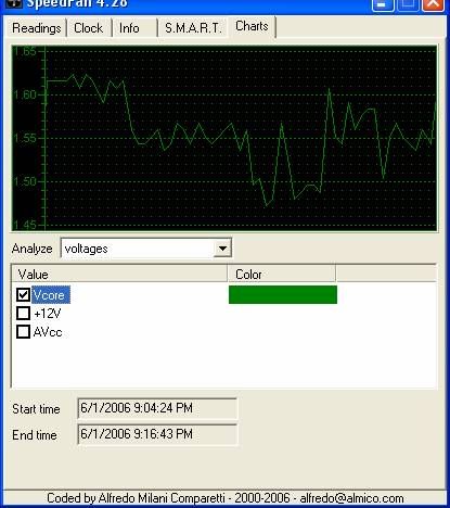

My problem is that it seems to require unusually high vcore settings to run stable when o/c. In order to get it to stop rebooting while running 2 instances of Prime95 I had to raise the core voltage to just below 1.6V. (This was done in small increments). It then seemed to run it ok for a couple of hours but when I tried 3D Mark 06 it crashed on the CPU test (without rebooting).
I raised the core voltage to 1.6V and it ran through 3D Mark a couple of times ok, but now it keeps crashing on the 2nd CPU test.
I think the vcore is dropping a lot under load. I had the Asus PC Probe running while it was doing Prime95 and when set at 1.6V it would appear to drop as low 1.5V. I'm not entirely sure of the accuracy of this program as it displays the core voltage as high as 1.66V on idle which doesn't tally up with CPU-Z or the normal BIOS readings.
Should I consider raising the vcore a bit more and is it safe to do so? Could there be another issue involved?
My CPU temp goes as high as 60 when under full load, is this OK? Does anybody know at what point the 805 starts to throttle itself back?
Does anyone have any idea what the long term effects of running a CPU at this high voltage could be?

You figured out your own problem I had the same thing on two of those boards , 1.6v is just fine , it is high for 3.8ghz.
I expect most can
now to your problem install/run speed fan and check the cpu voltage when running the cpu test on 3dmark06 if it drops like this
asus probe is kind of accurate it is a vdroop problem
, you'll need to do the volt mod. (not hard at all but i do alot of this stuff)
You can search google for the vmod, if not ill try and find it again for you.
while your at it check you 12v with speed fan under load also that can be dropping to much also. <that more a psu issue
by the way i have been as high as ~1.62 @ 4.32ghz normally 1.57v 4.1ghz

Thanks for the replies! My RAM is set as high as it will go (it is 800Mhz RAM after all) which means 760 at 3.8 (off the top of my head, somewhere around there anyway).
I really don't fancy taking a soldering iron to my new £130 motherboard (also, I've not got a lot of soldering experience and would need to buy a more accurate iron than the one I've got as it's quite big).
I'm more inclined to try the pencil mod. Do you know how risky this is? Also, if it's this easy to make the vcore stable it makes me wonder why Asus didn't just attach a resistor to it in the first place. Do you know how it works and if there could be any long term effects?
The only other thing that's concerning me is my temperatures. I think I may have applied too much paste and am considering trying to wiggle the CPU block to squidge out the excess. Is 60 at 1.6V too hot for water cooling?
Oh, one more thing: As I'm running the RAM below spec I thought I might try tightening the timings, but when I set it to manual there is one more timing setting than I was expecting. Do you know what the settings on this motherboard should be to run the RAM at CAS 4?

First the you run speed fan?
Dont worry its most likely not your ram, if you enetered it manually it was right from the ram correct?
It is either vdroop on the cpu or psu. I go with the cpu vdroop
the pencil mod is just fine I have only recently (2 months) did the hard mod but there does not seem to be any ill side effects. The one thing is there is going to be a voltage difference so set the vcore lower.
As far a why it needs the vdroop mod it because of the voltage regulator setup asus did not put 8 phase power like gigabyte does, if you check out the link it goes more into detail
