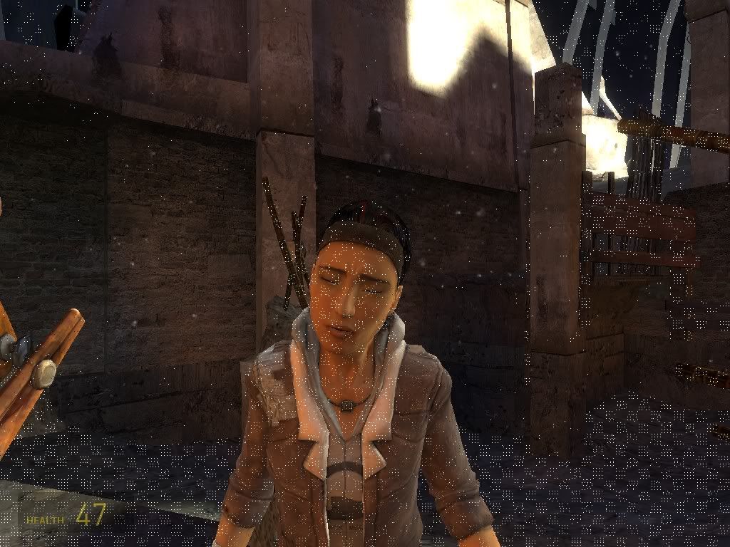

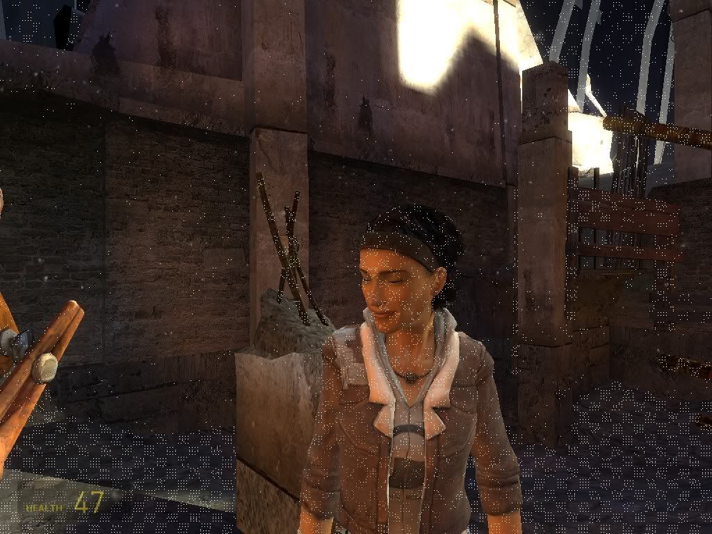

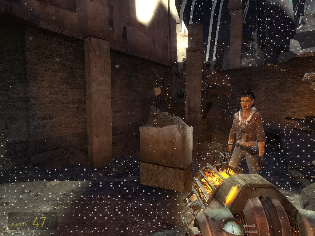

I'm having some problems with any gaming on my pc recently, most notably HL2 and HL2 Episode One. I find that white dots appear on some structures and such within the game at sometimes random times... its much worse in Episode One, I'm not quite sure why either. My system also seems to be under a lot more stress as a result and frequently crashes. I've also noticed the crashing in Oblivion (the only other game I've tried).
My problems started when I used system restore due to my desktop doing some random refresh every 3-ish seconds, not sure what caused it, but it made gaming/doing anything on my computer impossible. After the restore the refreshing problem was fixed but this new problem arose.
I've reformatted, reinstalled the game, changed to omega drivers, tried ati drivers, and I'm completely out of options... any ideas?
My computer ran fine before, and run both HL2 and Oblivion fine before the refreshing problem began.

I'm guessing that either your graphics card has suffered heat damage or some software is (unknown to you) overclocking your card.
Try downloading ati tool
http://www.techpowerup.com/atitool/
and click on default, if this doesn't change the core or memory speeds then half each. If this doesn't fix the problem then I think your card is damaged. If it does work then you can try finding stable speeds.
Bit of a shame this happened but the desktop refresh thing makes me think spyware but who knows huh.
Do you get white dots in any other games, it might be your card is mistakenly trying to render directx 9.0c commands when it can't do it. Come to think about it, I remember people reporting dots on their screen when they wanted to play DX8 games with a lesser card. See if you can play relatively older games without problems.

Hey guys, correct me if I'm wrong, but isn't this something elses fault? The white dots showed up in a print screen, so they are being drawn BEFORE it hits the video card yes? If error shows up on print screen, anything else, if error doesn't show up on printscreen, then its the card. This is the rule of thumb I've used. Whats the temp of the system/CPU? Can you test it in another computer?
July 9, 2006 10:47:02 AM
You could be right but by my logic, only the graphics card can render the scene. Thus, the graphics card renders the scene and you press the "prt scrn" button and get an image of everything that the graphics card rendered. There's no way you can take an image of software rendered half life 2.
Now if his problem was that he got white dots in say, internet explorer, but not the half life 2.
Now, I'm not saying his RAM or CPU is not to blame, just lets go with the more obvious first.
*EDIT*
Also, if you look at the picture you can see a pattern of how the dots become more prominent on the more complex areas of the picture - they are not just spewed anywhere and everywhere. I wouldn't be suprised if it was a shader, AA,Af or lighting problem.
July 9, 2006 11:01:01 AM
if you look at the posted images the white dots are patterned across only parts of the screen an a kinda uniformed manner. its probly a error further up the line when the scene is being rendered. i have no idea why ram or CPU would cause this. ram or CPU errors would also show in windows not just in games. also, prntscrn grabs a picture of the rendered image. before it gets to the screen.
its the card. ill bet my breakfast on it.

Looks to me like the core is overheating. I'd look into that first. Have you checked the condition of your heatsink/fan? Make sure the fan is spinning and carefully blow/clean all the dust off of it. If you still have the problem, you could try opening the side of the case and blowing a large desk fan in at it to see if it's heat related. If it is then fine, You could use ATI tool to underclock the core 20MHz, or just get better case flow, remove/clean/reseat the heatsink with AS5, etc.

I underclocked my card and the problem persisted, so I opened my case, sure enough the fan was not spinning on my 9800 pro. I'm planning on upgrading my entire computer (well, mobo, processor, gfx, memory) when intel drops their new processors at the end of the month, but I guess I could replace it until that happens.
Any suggestions on what heatsink fan replacement I should get? (hopefully my card isn't fried, and can still be recovered; it seems to be working fine now with my case window open and a case fan blowing directly on it)
