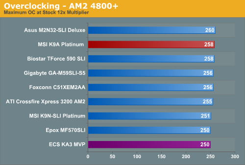

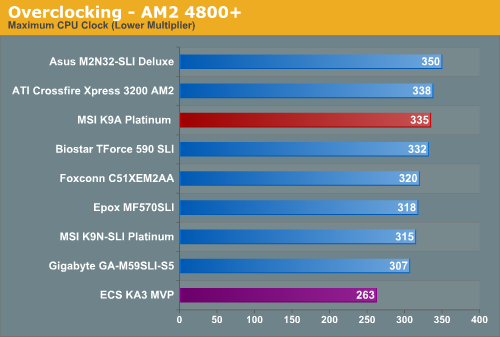

August 26, 2006 12:44:01 AM
All right.
The DFI INFINITY NF ULTRAII-M2 is an excellent overclocker. If you get this board, it won't be the motherboard that is holding you back with overclocking. Make sure you check out this thread: DFI Street Thread. 40C is rather hot for idle, as mentioned. With stock cooling, which is GREAT, you should be getting mid to high 20s for idle, 40ish for load, 50ish for an OC'ed load. Arctic Silver helps, but Zalman paste is better. Not perfectly centered, but as close as you can get without popping out a ruler.
Yeah, the DFI mobo is nForce 4, but it is a proven chipset and is guranteed to OC great. I haven't heard much about the OCing of other chips...
Check out these charts:
nForce 5 versus nForce 4 is pretty much only going to get you a few new features, some more SATA ports, and one less IDE port. Your call. It may not seem this way, but I'm not biased toward either chipset. Both are good, just saying that the DFI is a great OCer.
~Ibrahim~
