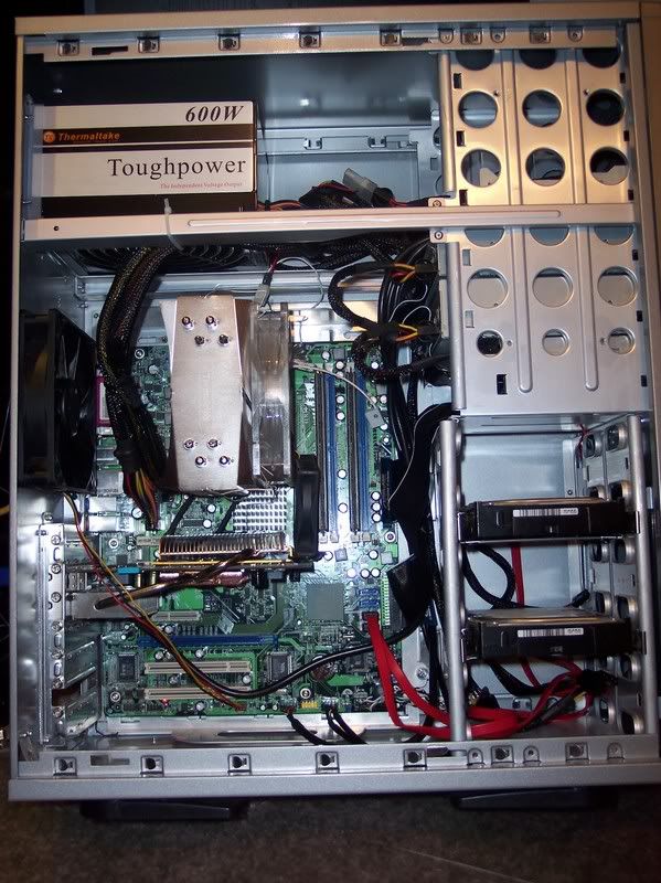

case
http://i109.photobucket.com/albums [...] 0_1000.jpg
