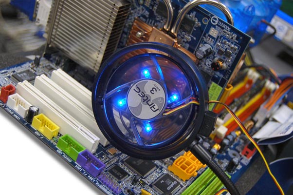

spot fan. screw onto mother board mounts. not too loud. get two and point one at the one at the cards and in front.
antec spot cool - uk
Your air flow is optimal. if you want to get rid of the heat in the dead space between the cards you can either get this
or the antec mentioned above....

I would sugest putting the Antec air duct back in with the cpu part out sucking air in to cool the cards.....but since they blow hot air out....it is no good.....unless you can add some kind of baffle to redirect the hot air away....or suck cool air from the side more....
But i do think that your temps are safe for the most part...those cards can take allot of heat

Quote:
So, pick a center point that is directlybetween the RAM and the HSF intake fan,
and that should be the axis of rotation
of that second fan.
