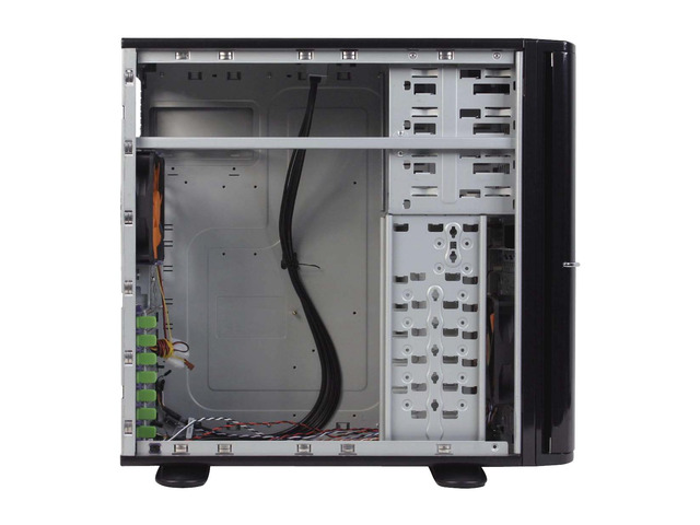

Here's the case I would like to fit it into
Thermaltake Soprano

The Thermaltake Soprano looks like it might have trouble with the 8800GTX http://images10.newegg.com/NeweggImage/productimage/11-133-145-06.JPG
The Thermaltake Swing looks like it has some extra space where a 8800GTX would hang off the back of the motherboard. http://images10.newegg.com/NeweggImage/productimage/11-133-172-08.jpg

As several people have said already, measure your case from the PCI bracket area and to the right 10.5 inches.
I have heard many people say that their GTX extends just to the edge of their mobo. As this is no general rule for all mobos I'd measure it out but I would say "most likely" the GTX will fit in most cases where there is at least a little room to the right of the mobo edge. Thats hearsay tho so don't say I said it as absolute fact :).

I did see one report of a GTX fitting in a Soprano case.
http://forums.anandtech.com/messag [...] id=1959556
Reply to WR2
I have the Thermaltake Tsunami case, and had to notch the HD cage on the MB side of the case.
A 1/2" or so notch allowed the GTX to fit.
GTX extends a smidge over 1" past my P5B deluxe wifi MB.
Dremel and I took about 10 minutes to notch ( halfmoon shape) the HD cage and put my two HDs back in.
I have a clear side window with fan, and the notch is not visible from the outside looking in.
