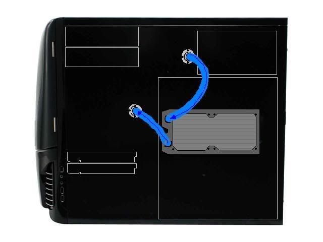

Would there be a way of fitting a water cooling system inside my case? I can use a screw driver and that's pretty much the limit of my technical abilities. I would like to avoid having stuff outside my case. If it can't fit I might just get a new case as well as a water cooling system.

You will always want your radiators to have fresh air you can either do this by placing them outside or drilling huge holes for them to intake to inside the fan, Here's a picture if im not being clear enough.
The Swiftech Radbox has become widely popular for placing the rads outside the case, but its $20... with some heavy duty double sided tape you could do something like this:![]()

If you want a quiet setup the BIX isnt the right radiator to use. The BI pro will do better with quiet fans in the Black Ice range and the PA models from Thermcchill are probably the best for use with lower powered fans with the Swiftech rads probably a little better than the BIPs,
With that case you should have no problems top mounting a rad but would lose the use of the top 2 drive bays.

Ancient 1, yes that was what I was thinking, except maybe running the tubes through my 5.25" bay.
For the design of the loop I was thinking: 5.25" bay reservoir -> pump on the bottom of my case -> cpu block -> radiator tubing going through a 5.25" bay-> reservoir
Would it be better to insert my VGA block after my cpu block, making a longer loop because it would have to go up form the bottom to the cpu then back down to the VGA card then back up to the radiator; or putting the VGA block before the CPU block, minimizing the length of the loop but providing warming water to my CPU?
Or I could do it like this: reservoir -> pump on the bottom of my case -> radiator through the back of my case -> CPU -> VGA -> reservoir.
Which of my 2 plans would work better do you think, or are they both crap?
Also, would I have to cut stuff to get the tubes through the back of my case? Like I said before I would like to avoid this, and also I can handle a screw driver and that's about it sadly.

Order makes basically no difference (the water moves fast enough that in the loop the warmest to coolest is less than 1 degree). It is better for the pump somewhat to have the res just before it but not needed.
Routing your loop to have the least tubing and sharp bends means more and even the length of tubing isnt that big of deal (if I remember a sharp 90 has as much restriction as 1' of length).
As for the Yate Loons unless you are going for complete silence I would suggest stronger fans. Personally I sleep with my puter aprox 2' from my head and I have 2 Delta VHEs on my rad and a 108cfm sanace on top all running @ 12v and would have trouble sleeping without the noise (I think I got used to the sound of rushing air as a kid when the main air conditioner duct went through my bedroom closet).
Sorry I missed this. Best would be to drill two 7/8~1" holes and put in grommets to keep the tubing from rubbing on the sharp metal. Then if you removed the water cooling you could just use snap-in plastic plugs to cover. I would guess that both the grommets and plugs would be available at most auto parts or hardware stores. I am pretty sure the grommets are included in the Swiftech kit.
