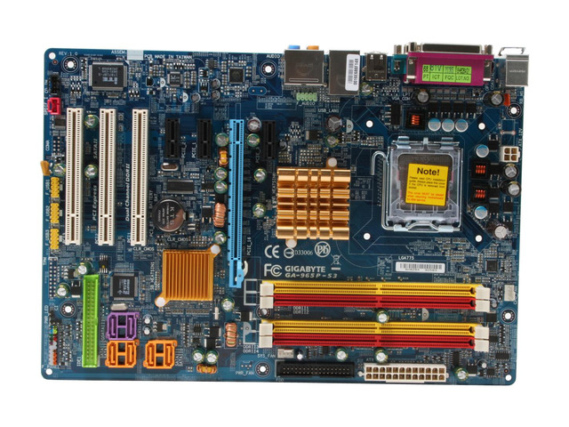

Here is my humble suggestion for a very budget concious rig with very nice performance that will completely out do your brothers comp and probly for cheaper than what he paid.
Core 2 duo e6300 $191 (overclock this baby ~3.2ghz with ease, and go further with more experience)
ARCTIC COOLING Freezer 7 Pro cpu heatsink $29
GIGABYTE GA-965P-S3 $108
G.SKILL 1GB (2 x 512MB)DDR2 800 $109
Seagate Barracuda 7200.10 250GB $79
XClio 450BL ATX 450W Power Supply $39
Rosewill Mid tower chassis $52 (or a decent case of your choice)
eVGA GeForce 7600GT KO 256MB $139 ($119 after mail in rebate)
LG Black super multi drive $29
Total Cost for all the components: $775

No, if you look carefully at the new motherboard(s) you will see that they require a power supply with a 24pin motherboard connector, the old motherboards and power supplies were 20pin. Also the motherboard needs an additional 4pin power connector located to the right of the socket in the picture below.
http://images10.newegg.com/NeweggImage/productimage/13-128-017-09.JPG
Also the graphics card requires a minimum of a 400watt power supply.
