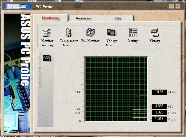

  5. thanks for all your help so far...just wanted to post a pic of my ASUS Probe PSU stats...
    Would this be the reason my PC is running slow? How can I tell if my motherboard/CPU is fried and causing the slowdown?
    My CPU is running at 41C/105F...
    My Motherboard is 34C/93F...
    CPU Fan = 2960
    PSU Fan = 0 (could this be what's causing the voltage probs?)
    Chassis = 2311
  6. If your CPU or Motherboard was fried you wouldn't be able to boot. The best thing to do at the moment would to buy a cheap power supply and see if that solves your problem. 10.5V on the +12V is EXTREMELY (And I can't stress this enough) low. I'm amazed you can run your system at all.
