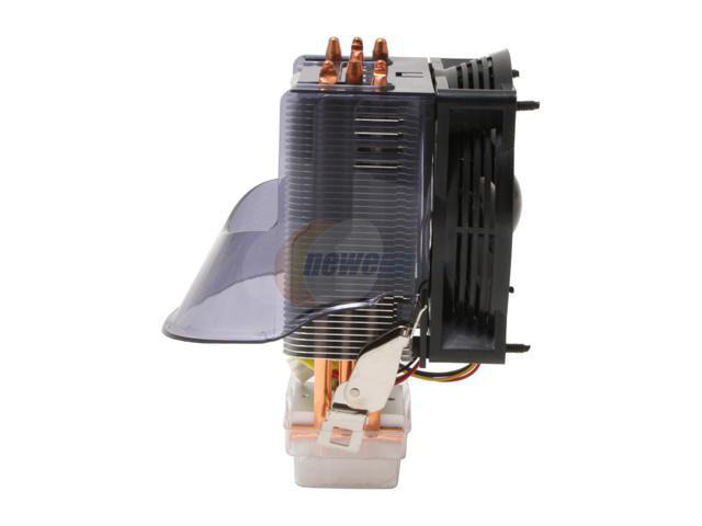

Cooler Master has an interesting freezer pro clone that addresses this issue, the RR-DCH-S9U1-GP 92mm CPU Cooler
http://images10.newegg.com/ProductImageCompressAll/35-103-011-03.JPG<--clickage
It is a shroud that directs exhaust air downward to cool the voltage regulators.
