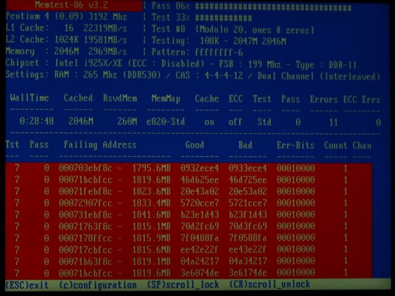

Well, I should probably say that my system is a Dell XPS Gen 3 with an intel 925x based mobo, and powered by a P4 Prescott 540 3.2ghz 32bit CPU with Hyperthreading (currently turned on.)
I never ran memtest on my PC before last night. Last night I ran memtest86 on my system. It took approximately 35 minutes to complete the first pass. In test 7 it detected 11 errors. Included is the photo that I took of the screen, I apologize for the dark tint, but I need more experience with that camera.
I then let it run while I slept for the next four hours. When I woke up, it had been running for nearly 5 hours, and as I groggily remember had accumulated nearly 500 errors.
Now, I do not know what this indicates, nor what further tests I should do to determine the issue. Ideas that I have come up with are: a) benchmarking the system using 3dmark06 with the original ram alone, and then in comparison, using the new ram with the old ram. I surmise that since 3dmark06 is a newer benchmark it will reflect amount of RAM present more effectively than 3dmark 05

The errors are between 1780 or so and 1840mb which would seem to mean the 3rd dimm whichever one that would be.. I would assume the first one of the new pair.

OK, your system is most likely a dual-channel setup. The memory most likely is read in this order: Old 1, Old 2, New 1, New 2. Memory boundaries in this setup are probably as follows : O1 0-512MB, O2 513-1024, N1 1025-1536, N2 1537-2048. Since the errors are in the 1700-1800 range, that'd be the fourth module.
Troubleshooting steps:
1) Remove all memory.
2) Install one module. System should boot, just in single channel mode.
3) Run Memtest.
4) If module passes, remove it and insert the next.
5) Repeat until you find the bad module.
6) If no modules test as bad, then you may have a faulty socket. In that case, you're screwed.

The memory you bought was a matched pair, so you'll have to return or RMA the set, not just a single module.

Removed old dimms w no difficulty
put in new dimm sn ending in 93
took a lot of work to get it in. Im not so good @ that i guess. I put in in wo force then closed the clips halfway then pushed the dimm until it the clips went in the holes halfway. Then pushed in the dimms the rest of the way. Then the clips in the rest
currenly memtesting dimm new sn93

Since all the modules tested clean, install all 4, making sure that each one is firmly seated and run the test again to see what happens. If you can remember, put the modules in the way you had them before your problems started. That way each bank is a matched pair.
If you start getting problems again, try rotating the modules to different sockets. If you get errors in the same range, then it may be the socket or the power supply. Dell buys from the lowest bidder, same as anyone else. Despite what the placard on the PSU says, it may not be putting out the power that is stated. Hopefully they used an ATX standard case so you can replace the PSU if need be (Dell and other companies have often designed standards defying chassis to prevent 3rd party replacement of key parts like the mainboard and the PSU).
