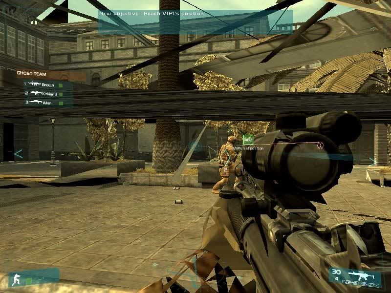

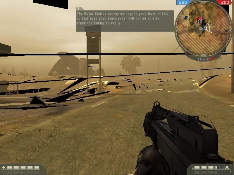

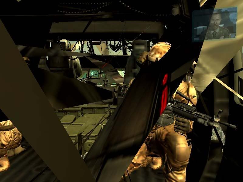

Hi, ive recently brought a winfast 7600gt and it seems to be strugling with lots of games. ive installed the appropriate drivers, it does seem a bit wierd can only select 3 different resolutions though. right the games are looking like this
http://i127.photobucket.com/albums/p131/tom32y/screenshot2.jpg
http://i127.photobucket.com/albums/p131/tom32y/screeenshot3.jpg
http://i127.photobucket.com/albums/p131/tom32y/mini-untitled.jpg
http://i127.photobucket.com/albums/p131/tom32y/Screenshot.jpg
i sent it back to the company once and they sent it back to me giving the all clear saying they had tested it to death but no faults were found! does anyone know how i might be able to solve this problem??? Thanks

That's not a performance issue; those are artifacts like seen when oc'in the video ram too high. It's a bad card. If possible confirm it by trying the card in another rig.
