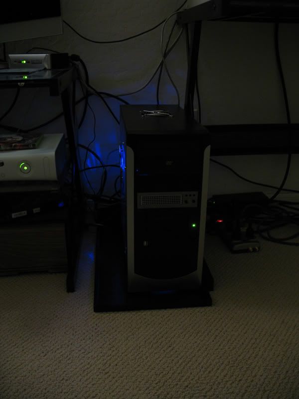

Hey guys whats up? Haven't had a chance to post here much but I figured I would get your guys input and comments on a few things.
I built my new pc about a year ago and its been great so far let me know what you think!
Asus A8N-SLI Premium
AMD 64 X2 4400+ (Socket 939)
Corsair XMS PC3200 1024 x2 (in CPU-Z it says: PC3200 (200MHz) shouldn't it be 400?)
PCI-E Geforce 7800GT
2x Western Digital 250GB HD 16MB Cache in Raid 1
http://img.photobucket.com/albums/v113/NtegraDryvr/My%20Setup/IMG_00021.jpg
http://img.photobucket.com/albums/v113/NtegraDryvr/My%20Setup/IMG_00041.jpg
http://img.photobucket.com/albums/v113/NtegraDryvr/My%20Setup/IMG_00061.jpg

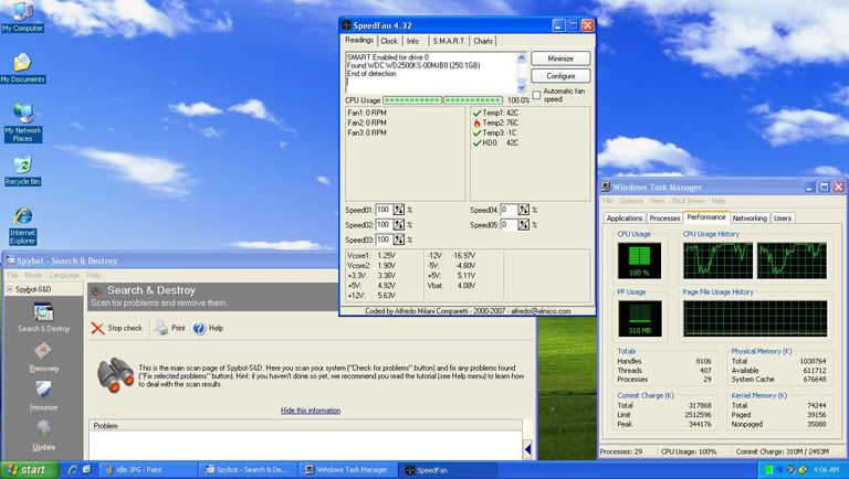

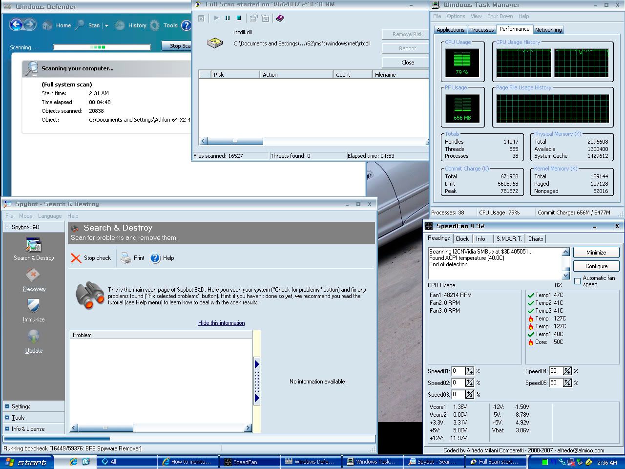

How do my temperatures look after being at 100% for about 10min? Also why does it show that 2 of the sensors are at 127º? Also how bad is it that the Core spikes to 50º after being at 100% for a bit?

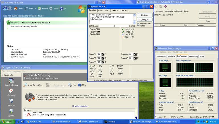

While on the subject I built my mom a Pentium D 915 w/ stock HSF & Arctic Silver 5. 1GB Corsair XMS DDR2 800 on a Gigabyte motherboard (budget build). Unless I am completely missing something the damn thing runs HOT!
IDLE: Nothing Running
http://img.photobucket.com/albums/v113/NtegraDryvr/My%20Setup/idle.jpg
FULL LOAD: After everything running for 45-60 seconds!
http://img.photobucket.com/albums/v113/NtegraDryvr/My%20Setup/fullload.jpg
WTF DO I DO! Its brand new and I have to ship it 16 hours away to my mom so this thing has to last!

Also the DDR on the AMD reports 200 since that is the FSB, double pumped @ 400Mhz
Reply to doolittle
Your AMD cpu temp is about the same as my overclocked C2D core temp. 46'c idle & 51'c load. Intel specs list max 61'c.
Your mom's P-D is pretty hot at full load. Could you take a photo of it? What are the case & case fans? Is it overclocked? A quick fix is to disable Q-Fan for ASUS or any cpu fan speed control in bios. The fan will run at full speed & is loud, but it'll cool the temp down.
Reply to akhilles
Sorry I wasn't clear enough. The Pentium D is on a Gigabyte GA-965G-DS3 Mobo. I have 1 80mm intake fan on the front, 1 80mm intake fan on the side, 1 120mm exhaust fan in the back, 1 120mm psu fan inside the case. Its stock heatsink and fan w/ AS5 and NO overclocking!

Update the bios to the latest. Ditch speedfan. Google & install:
Thermal Analysis Tool
http://www.thecoolest.zerobrains.com/CoreTemp/
Speedfan isn't the most accurate. TAT & CoreTemp are more accurate. Note they read core temps not die. So they should be higher. For reference, my range is 46-51 overclocked.
Reply to akhilles
I updated the BIOS to the newest version and TAT will not work on a Pentium D (mine atleast) and neither will Core Temp.

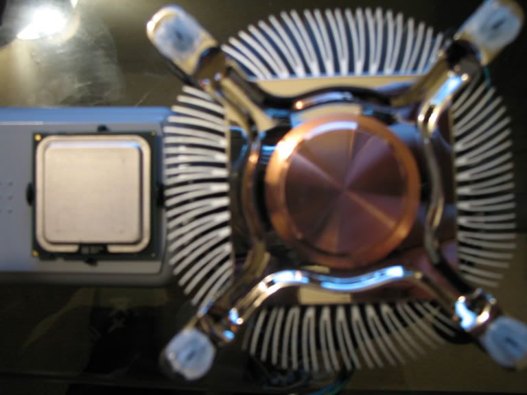

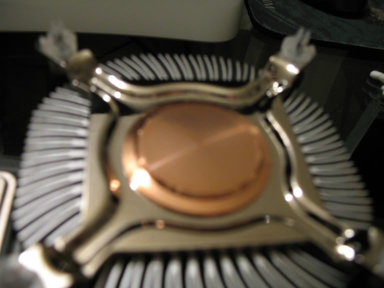

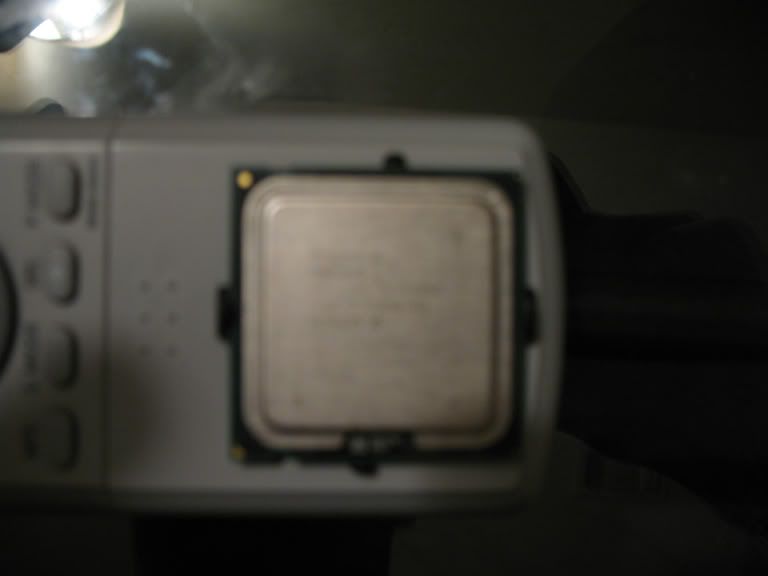

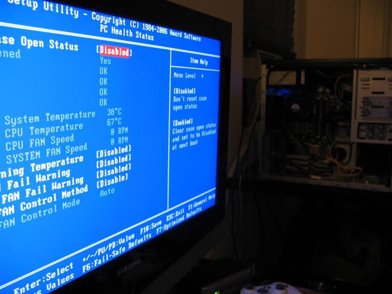

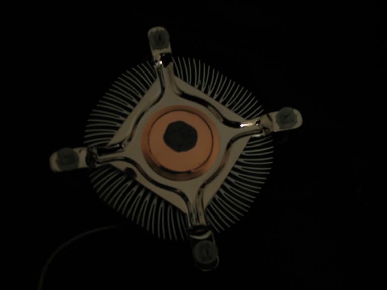

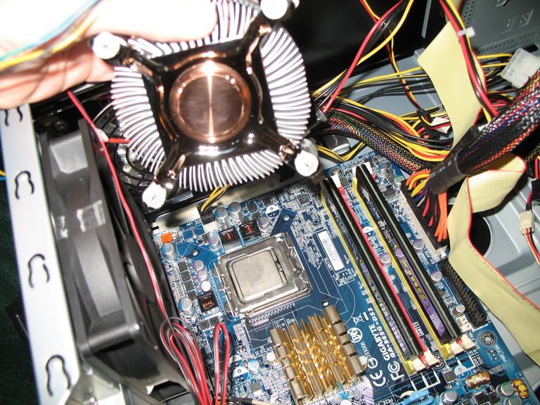

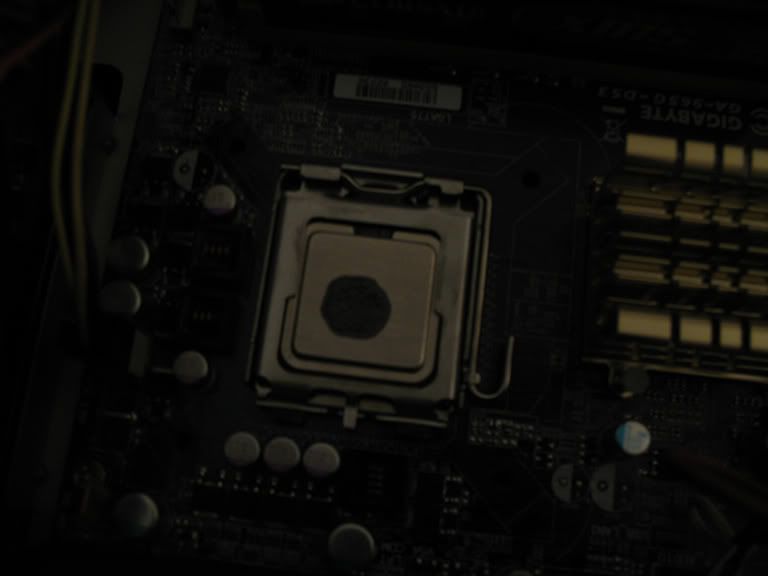

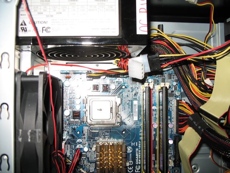

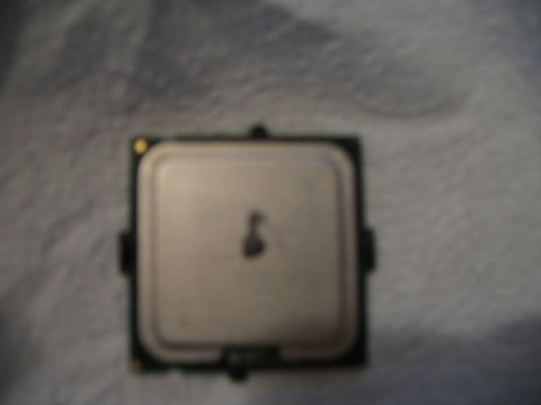

Okay so I did everything everyone suggested, I figured in the end less is more with the AS5. Evidently not... here are some pics of the process and in the bios after 3 minutes I am sitting at 65ºC CPU Temp (and still rising as I type this, shown in pics) and the CPU fan speed at 2636, System Temp 35ºC and the room is cold....
http://img.photobucket.com/albums/v113/NtegraDryvr/My%20Setup/Picture001.jpg
http://img.photobucket.com/albums/v113/NtegraDryvr/My%20Setup/Picture002.jpg
http://img.photobucket.com/albums/v113/NtegraDryvr/My%20Setup/Picture003.jpg
http://img.photobucket.com/albums/v113/NtegraDryvr/My%20Setup/Picture004.jpg
http://img.photobucket.com/albums/v113/NtegraDryvr/My%20Setup/Picture005.jpg
http://img.photobucket.com/albums/v113/NtegraDryvr/My%20Setup/Picture006.jpg
http://img.photobucket.com/albums/v113/NtegraDryvr/My%20Setup/Picture007.jpg
http://img.photobucket.com/albums/v113/NtegraDryvr/My%20Setup/Picture008.jpg
http://img.photobucket.com/albums/v113/NtegraDryvr/My%20Setup/Picture009.jpg
I pressed the Heatsink down on the processor and it spread out to a quarter like shown but I figured it was alittle thick so I cleaned the heat sink off again (another 10 qtips in alcohol for 10 minutes no grease left). You can see that I left the grease on the processor and then reinstalled the heatsink as per the instruction asus provides with their motherboards which were detailed and very helpful!
I'm going to call newegg asap and see if they will take back the board, processor, and ram and exchange it so I can get an AMD setup as this is complete BS.
Please tell me that it is ME and that I am doing something wrong and this isn't a usual circumstance.

I am sitting in windows 10 minutes now 0% CPU Usage and my temps in speed fan are 40C & 44C. The second I do anything the temps jump up and I get the flame icon... (50º+C)
Edit again:
Running something as small as CCleaner and making the cpu spike to 45% usage makes the temps hit 56ºC.

My bad. I thought it was c2d. Pentium 4 & D are kinda hot. Your temps in the 1st post are about right.
