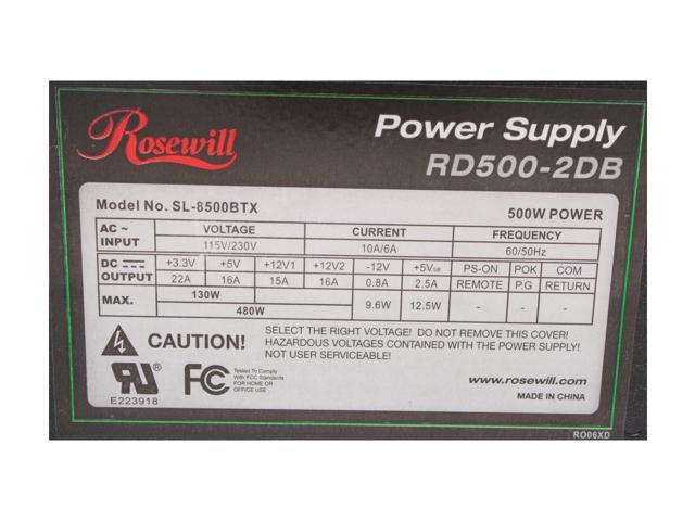

PSU Specs
Type: ATX 12V Ver.2.2
Maximum Power: 500W
Fans: Dual 8 cm ball bearing fans with LED light
PFC: No
Main Connector: 20 + 4Pin
Dual +12V: Yes
PCI-E Connectors: 2 x 6Pin
SLI Support: Yes
Modular Cabling Support: No
Over Voltage Protection: Yes
Input Voltage: 115/230 V
Input Frequency Range: 50/60 Hz
Input Current: 10ARMS max. for 115 VAC 6ARMS max. for 230 VAC
Output: +3.3V@22A,+5V@16A,+12V1@15A,+12V2@16A, -12V@0.8A, +5VSB@2.5A
MTBFP: >100,000 Hours
When I first built the PC, the video card idled at round 48 Celsius, but now idles around 52. This is most likely due to the fact it is no longer below 30 outside and my apartment is no longer an icebox. I know the 1950Pro runs hot, I see it get up to 75 Celsius regularly (probably over). I am pretty sure the higher temperatures are straining my already inadequate PSU, causing the reboots/lock ups. Or are the high temps are being caused by the inadequte PSU. (I'm not the most hardware-savvy person, so *shrug*.) I do not think my card is merely 'overheating'.

I see that your 12Vrails have 15A and 16A, but what's the Voltage output in those rails? Tell me please if you can. Because you may not have the 31A you think you have.
Reply to pmr
I guess I am not sure what you are asking. From the label it doesn't look like there is a "max" output (as in each rail is 15A and 16A respectively but there is a max of 25A or something like that). For simplicity sake here is an image of the PSU:
http://images10.newegg.com/NeweggImage/productimage/17-182-044-04.JPG
Reply to pretendeka
- 0 +
Well, you seem to have enough Amps on the psu and it should run a higher system than yours. Maybe she is dying...
Because the wattage output on the 12v raisl (350W) divided by 12 (12V) gives you the Amperage which is 29Amps in your case.
I'm not sure, but the rated Amperage on the +5V rail seems too low. 16Amps may not be enough
Reply to pmr

Yeah I think the real problem here is the X1950PRO 'requires' 450W on a 12V Rail and 30A to run properly. I guess my real question was if the Thermaltake in addition to my current PSU would be able to provide that, and still be okay for the rest of the components in my system.
Reply to pretendeka
- 0 +
That's not true. I know guys running a x195'pro in 22Amps. ATI enjoys seeing people burning money on super priced psus...
So, that leads me to think your psu is faulty or dying (if it's psu related).
As for buying that thing, was a good idea if you know your psu is healthy. Because you may buy the thermaltake one and still have the main psu fucked up.

Yeah I guess from peoples recommendations you should use a 30A+ single rail or 22A+ dual rail PSU for all the x1900 series cards. I think I will go with the Thermaltake PSU 'booster' and toss in a PCI fan for good measure.
Reply to pretendeka
I haven't had good experiences with Rosewill PSUs. My roommate had one (a 550W I think) for a year or so and then it started chewing through motherboards (2) until we got it replaced. So I would replace the PSU on general principals anyway.
