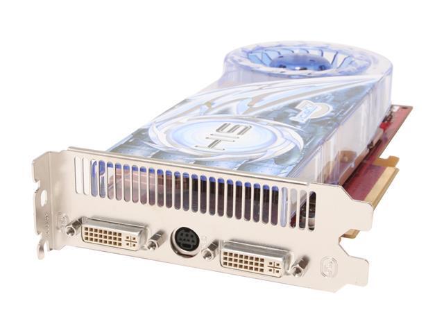

I agree with Cleeve, you don't care much about the core temps of the card, you need a card that simply exhausts all that heat out of your case.
Anything with an AC style cooler will do that [Like HIS' IceQ series]. Even the new GF8800s are going that route now whereas previous nV coolers dumped half the heat in and half the heat out of the case at best. But it's not limited to just one maker, both have the dump hot air into case type.
Here's the X1950P as an example of both types.
You want one that looks like this;
NOT like this;
