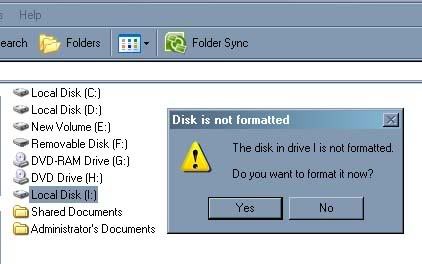

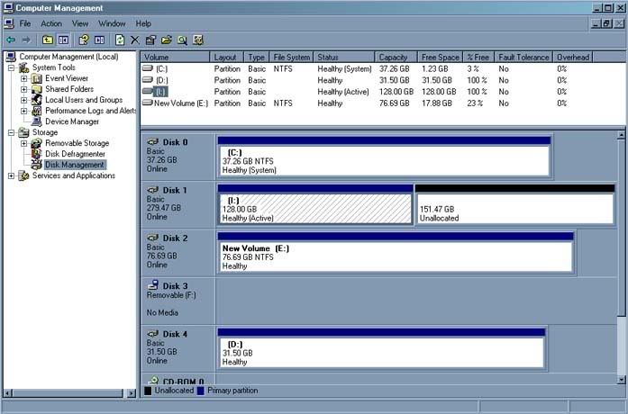

I currently have a: Maxtor MaXLine III 7L300S0 300GB 7200 RPM Serial ATA150. I have updated computers but when I plug my hard drive in... and when I click on <Manage> it shows up as a 128.00 GB drive with 154.47 GB Unallocated.
When I try to access my hard drive, it just wants me to format it:
I am running SP2 with an ASUS P5VD2-X board: both of which support 48 bit LBA's. It was suggested to me that my new BIOS has different geometry translation and will not be able to read the hard drive. Is there any truth to this?

Its viewing the entire partition as "BAD" and so none of the "Partition Options" are available.

I guess that the old disk was not partitioned and was fairly full so the solution for formatting the 2nd part is not applicable..
Also the first part has no file system and is reported as empty this is why the system ask you to format the drive ( letter I ) (the first part of the disk which is supposed to be in good condition).
In reality there is no first and second part on the disk,
The problem could be in the controller at least one of them or the drivers of it
Your mobo has 2 controllers (2 sata I ports and 2 sata II ports, one of the sata II ports is external)
If you have the OS (main) disk connected to a sata I port (one of the 2 close to the battery), connect the "problematic" disk in the port next to it. That port is also sata I and uses the same controller, meaning that you already have the drivers for that controller.
(If you have already a disk plugged in there, i see you have 4 disks in total, just unplug it and move it to the port you have the "bad" drive and check what happens then. if the problem "moves" to the other drive then you solved the problem for the moment).
if you use the sata II port (the one near the cpu ) then you must load the drivers for the other controller also there is a possibly that you set the sata II port in raid mode...check you bios to disable the raid function (that applies also for the sata I controller) and reinstall the sata controller drivers

So when you try to access disk 1 it asks you to format, seems like the OS is seeing the unformatted 151.42GB. Could you format that portion? Seeing as how the OS is seeing it as seperate, make it its own temporary partition, so that you can access the 128GB, copy all the information off, then recombine the 128+151GB and put your data back on... That was my suggestion.
