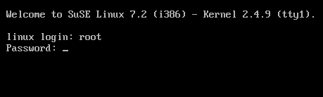

After it tries to go into runlevel 5 to start the GUI ( X.org )
You will see the mandriva equivalent of this login screen or something like it:
Hit ALT+CTRL+F1 to get to the text console which will look something like this:
except it will say something like:
welcome to mandriva Linux version x.x Linux 2.6.x
login: root
password:
Type in root all lower case and hit enter
Type in the root password ( it will not appear as you type it ) and hit enter.
Once you have successfully logged in:
wget https://a248.e.akamai.net/f/674/9206/0/www2.ati.com/dri...
chmod a+rx ati-driver-installer-8.23.7-i386.run
./ati-driver-installer-8.23.7-i386.run
follow the onscreen instructions to install
Good luck :-D
