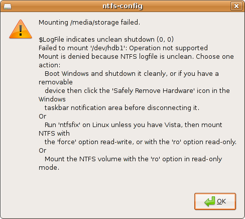

I installed NTFS-3G to get the ability to access my 250Gb storage drive I had from Windows with all my games, images, dvds music and anime on. Now I've been able to access it as Read Only, so I copied a lot of my important files onto my Ubunt drive (160Gb) so I would work with them.
Now I've got about 4.6Gb free on my 160Gb :lol: I set the NTFS-3G Configuration Tool so that it will let me have Read & Write access to my 250Gb drive, but soon as it mounts the drive again, this happens...
http://www.crystalnode.net/images/Screenshot-ntfs-config.png
I then cannot even find my 250Gb (because it failed to mount and is staying umounted.) So I reset the NTFS-3G config back to normal RO rights and everything is all cherry pie :P
Anyone seen this error before, and how does one fix it? I followed the information in the error, but no avail yet.... :cry:

I have never encountered that error.
I suspect ntfs-3g probably has a valid reason to complain.

Sounds like a classic case of the NTFS superblock showing that the filesystem was not unmounted cleanly.
If you've been trying the suggested solutions without avail, about the only additional thing I could suggest booting a Windows XP install disk, jump into the recovery console, and run a chkdsk to try to clean the filesystem to make NTFS-3g happy.
If that doesn't work, and you are adventurous, you can try using the command [code:1:0bc6857044]sudo mount -f -t ntfs-3g /dev/hdb1 /media/storage[/code:1:0bc6857044] to force the mounting. I would strongly suggest backing up important data from the drive before forcing mounting a filesystem: generally speaking the coders of the filesystem support in the VFS layer try to make sane concessions to get the filesystem to mount but it does make things a bit more hairy when some of the sanity checks are ignored.
Reply to bmouring
Quote :
8O I might just use the XP disc -> Recovery -> chkdsk method :)
