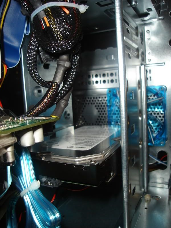

System done, little heat issue
I listed my build a few times before I bought it, I went with www.mwave.com and had them assembly/load/and test it. Just 1 problem with the it so far, the CPU idle is about 38-41C but under any load, game, test, it rockets up to 62-77C depending on the load. The resetting and re-paste will happen this weekend and I pray that fixes it.

I am currently going to work on great air flow in the case.
Here are the pics:

  1. Looks like a solid build.
    The fans are not that great. The rear fan mount can hold a 12 cm fan, the side an 80mm & the front 2 80mm. I'd upgrade the fans to 4: 2 front intakes, 1 side instake & 1 rear exhaust, then either move the hdd to the bottom or top, not in the middle. Top may be better for airflow. You have to experiment with the fan & hdd locations.
    If you have better thermal grease, use it. The Zalman white stuff is average.
  2. Can you suggest some high air flow fans..noise doesn't bother me.
    Any clue how I can get another fan in the front of the case without removing the whole system and taking everything apart?

    1 120mm & 3 80mm & you're in biz. Yep, it's important to check the contact of the cpu hsf. It should still be able to wiggle a bit.
  8. in the front where your front fan is.. it fits two.. but that grill restrict HELLA air.. my case wus like that.. i just started cutting that piece out... and wen i tried it there wus much better air coming in..
