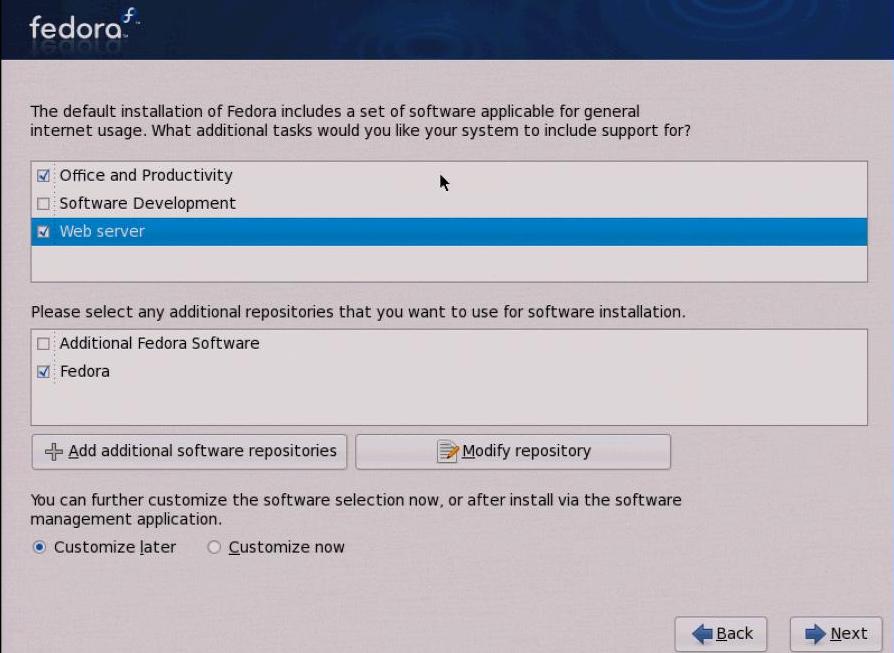

Install Fedora 10 and select the software development option during installation, in fact select everything.
Fedora has a bazillion commands and a lot of programming languages.
C, C++, Perl, Python, PHP, ruby, shell, java and a lot more.

What does all this yum, deb and rpm mean? Also how can i select the software development option if im using the Live Disc. will i have to download the full distro and then install? finally when i was running it off the disc yesterday, on the desktop there was the option to install to hardrive. i tried this but i cannot figure it out. i had previously made a 10GB partition in Vista but when i select this (sda\3 ... 4 or something) it wont let me install, it says i havent specified a root (\) something or rather. ANY ideas?

It's better to install from the 4GB DVD http://fedoraproject.org/en/get-fedora
It has an option for software development, select it.
http://www.thegeekstuff.com/wp-content/uploads/2008/06/fedora-installation-package.jpg
