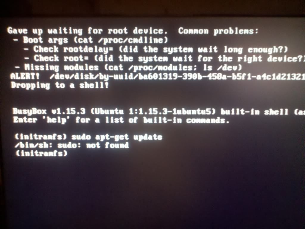

i updated my bios previously and when i went to boot my pc, i get this error message.
i also followed the instructions from the below post, but when i check the disk utility/partition editor (im using a livecd), my main hd (with the os on it), doesnt even show up. But its noted in my bios. my main hd is a 750gb wd 6.0gbps drive. its connected to my 6.0. the other internal hard drives show up.
http://ubuntuforums.org/showpost.php?p=7619590&postcoun...
i removed the internal hd with the os and plugged it in via dock and it shows up. its currently listed as sdh, but i know when i put it back in my pc, that will change. not sure what to do next. any suggestions?
