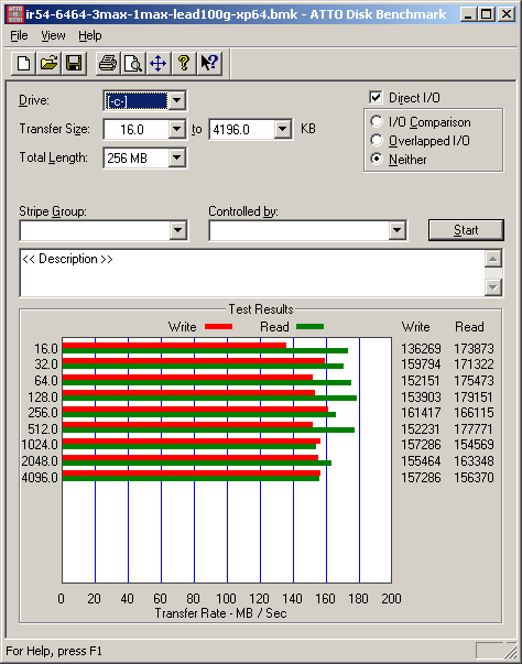

May 19, 2007 1:30:37 AM
With RAID 5, you need to be careful about write performance, and from some simple tests I've recently (ICH8R (ICH8DO) under Vista with 7.5 drivers), 128k stripe size is a particularly bad choice for RAID 5 -- write performance is much worse than with other stripe sizes.
When in doubt, the default is worth trying, and the default is 64k, and seems to give good performance.
RAID 5 also out-performs RAID 10 here in simple sequential read/write throughput test.
RAID 10 has a relative advantage in CPU utilization, but this should not be material in most cases. RAID 5 CPU utilization appears to increase with smaller stripe size.
You should have a backup for at least the important data even without considering the risk of migration. "RAID alone is not a backup." A backup/restore is also likely to be faster than a migration in this case.

May 19, 2007 3:23:39 PM
Quote:
With RAID 5, you need to be careful about write performance, and from some simple tests I've recently (ICH8R (ICH8DO) under Vista with 7.5 drivers), 128k stripe size is a particularly bad choice for RAID 5 -- write performance is much worse than with other stripe sizes.You cannot give a generalization like that. It depends on what the machine is used for. For large sequential reads and writes like working with large video files, larger stripes will perform better. For smaller files with lots of random access, smaller stripes will perform better.
I'm afraid that you're the one who's generalizing based on theory here, I'm reporting specific behaviour that I've measured, with a number of different access sizes.
How one applies that behaviour in their application is up to them. If you're OK with really poor write performance, for no appreciable benefit in read performance, then, it's a choice you can make. Dumb IMO, but yours to make.
Granted that my tests were only synthetic benchmarks in a specific setup. Consider it a "heads up". I don't accept random internet posts as facts either -- I'd check it for myself with my applications of choice.

Quote:
The only reason I got defensive is because you called the information and advice in my posts dumb and your tone was sarcastic. If I misunderstood you, I apologize.I accept your apology, and apologize in turn for using let's say unpeaceful language at times, although it wasn't intended as badly as you seemed to have taken it. I believe you've misunderstood me at times, particularly seeing disagreement when there isn't any, but I have not taste for going over these debates point by point, correcting every little unimportant detail and making more mistakes and misunderstandings along the way, etc., so I'll try to be brief, and get back to the subject with more data.
Madwand
May 20, 2007 5:16:16 AM
Quote:
With RAID 5, you need to be careful about write performance, and from some simple tests I've recently (ICH8R (ICH8DO) under Vista with 7.5 drivers), 128k stripe size is a particularly bad choice for RAID 5 -- write performance is much worse than with other stripe sizes.I did some more tests, now with XP-64 and 6.2 drivers, and got similar results.
Motherboard: Asus P5B-VM DO (ICH8R variant - ICH8DO). THG article used ICH8DH.
Drives: 4 Maxtor
Matrix RAID in initial part of disks. Tests run on formatted but otherwise empty arrays. Write caching was enabled.
Benchmark: ATTO diskbench.
Used largely for convenience and speed of read+write test. There is run-to-run variance, so don't read too much into individual results. Look at the order of magnitude.
Similar results were obtained with IoMeter simple sequential access and simple file copies. (I didn't test all access sizes.)
128k stripe size:
64k stripe size:
I can't guarantee that the OP will see this sort of behavior on his machine, but I think there is a case for a "heads up".
Don't look at read-only results when picking stripe sizes for RAID 5 if RAID 5 write performance matters at all to you. Ideally, test write performance for yourself in your own environment.
It'd be interesting to see if anyone gets significantly different write results with ICHxR RAID 5 128k stripe size.
