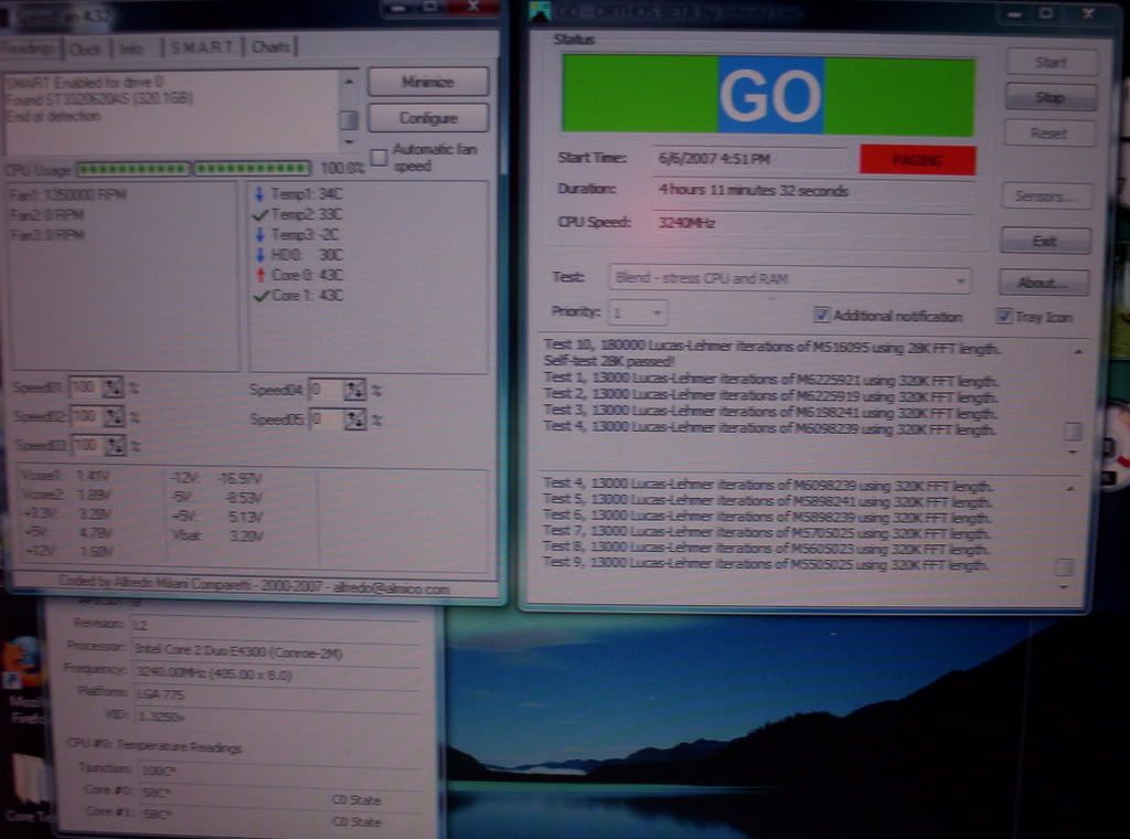

I have run into an oddity while overclocking. I have OCed an E4300 to 334x9 (3.0GHz) with 1.375v no problem. I wanted to go 1:1 on my RAM though so I pushed the FSB on my Gigabyte 965P-DS3 to 400x8 (3.2GHz) and lowered the RAM to 2.0, and it wouldn't post, even with 1.45v. So, I started upping the FSB more slowly. I went to 350x8 (2.8GHz) and 1.39v and it booted fine. I started an Orthos test and discovered an anomaly. CPU-Z was showing 350x8 (2.8GHz), but everything else in the computer showed 395x8 (3.16GHz)! What the hell? I have the "cool and quiet" options turned off (I can't ever remember what Intel calls those 2 options.) I upped it to 360, and again the same problem. 360x8 (2.88GHz) CPU-Z, 405x8 (3.24GHz) everywhere else. I ran some benches on SiSoft Sandra and my CPU, at it's reported 405x8 (3.24GHz), was slightly faster than an X6800! If it was running at the 360x8 (2.88GHz) that CPU-Z reports then I'm sure it would not have beaten Intel's fastest C2D, so I think the BIOS and CPU-Z are wrong. Everything else seems to report the correct FSB. Here's some screenshots to show what I mean.
-I've circled the FSB inconsistencies.

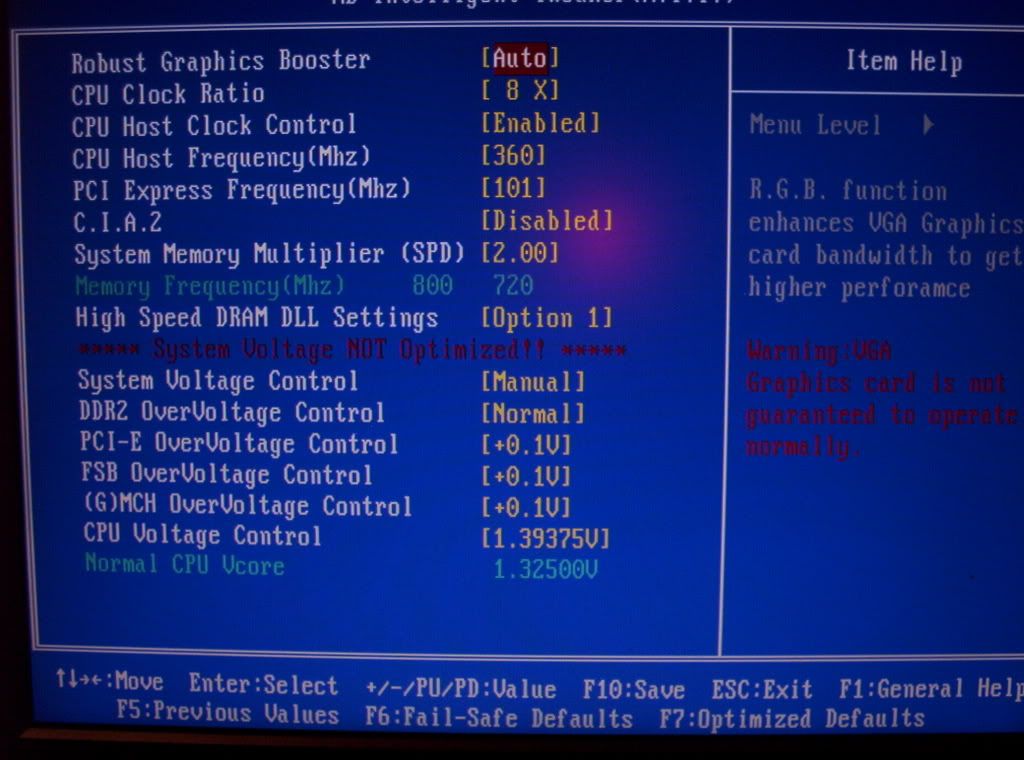

-Here's my BIOS settings

a friend of mine has the same issue with his 4400 at 3.15 GHz it shows as 3,55 GHz everywhere but CPU z, you will find that early CPU-Z version would show that 3.12 GHZ you talking about
That is very odd. Not sure if you noticed but 360x9 = 3240 It looks like it is still using a 9x multiplier even though you set it to 8x. CPU-z just reports it as 405x8 = 3240.
Try using a program such as Everest and see what it says the CPU multiplier is. Also, check to see what it's reporting your FSB as and what speed your RAM is running at.

E4300 SHOULD BE X9 multiplier at default, you set it to 8x, change it back to 9x. and lower the fbs to less than 333mhz (for 3 ghz) and test for stability.
what bios version? use F7+, probably your old bios doesn't recognize e4300 properly
are you overclocking your video card? if not then don't overvolt pci-e

The E4300 was x9 by default, I changed it. It's rock solid Orthos stable 14hrs at 405x8 (or360x9, whatever it is). I had it previously at 334x9 and it worked perfectly and seemed to report the correct settings. By BIOS version is F10, I just bought the board a few weeks ago. Yes, I'm overclocking the video card too.
@pax2all
So, you're saying the FSB won't reach 400? I though it was good up to around 450 or so. It would explain why I couldn't get 400x8 to work in BIOS. I am happy with the speed, out pacing the x6800 is awesome, I just wanted the RAM to run at it's full 800, and need the FSB at 400 to do so. 360 isn't off from that by much.
