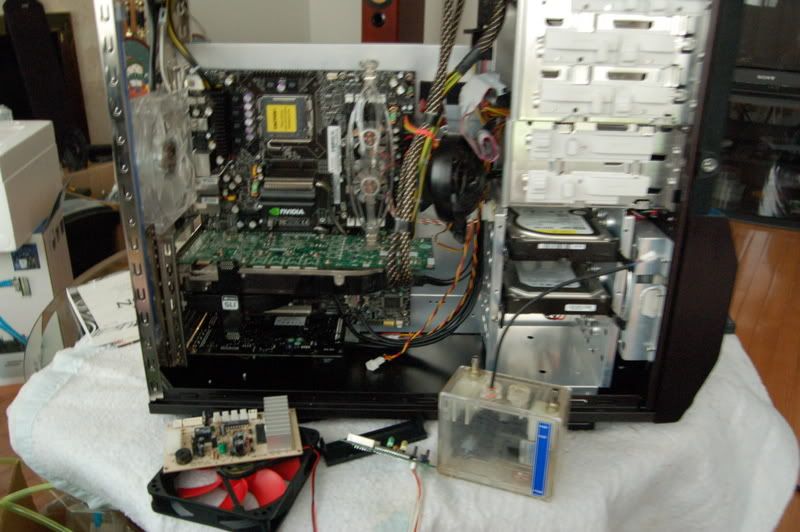

I have been useing a Freezone in one of my computers for over a year now. It is cooling an overclocked Opteron 165 (1.8GHz std) clocked at 2792MHz. It is extremely quiet. The only noise is the fan and that is very quiet. Under load of Prime 95 running on both cores it goes up to 58C, if I remember correctly (can't find my yellow pad that I wrote my notes on from a year ago).
If I overclocked any higher the temperature just would creep higher and higher; the Freezone is unable to handle any more heat generation. I even tested useing a much higher capacity fan and it only helped a little; but the noise of a 120CFM fan was intolerable for a couple of degree improvement.

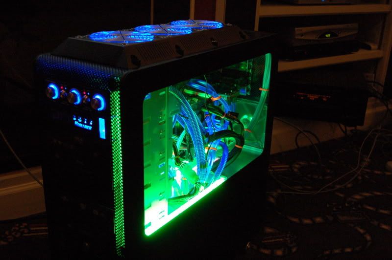

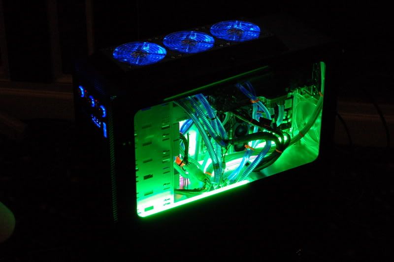

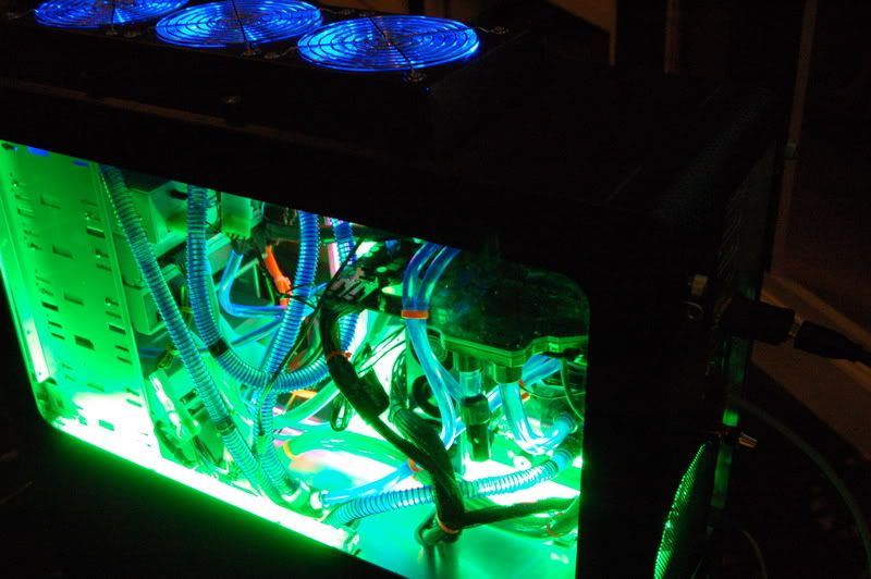

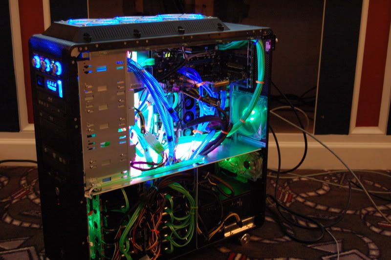

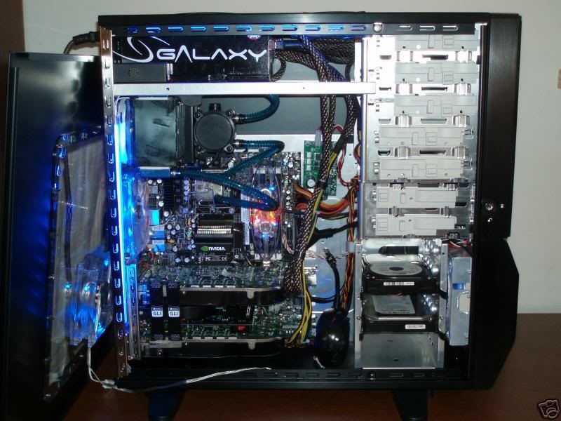

i am sure your operon will not keep up with the 3.5ghz or 3.7ghz quad system i build with intel - sure i can use this to cool my 3.37ghz e6600 based systems which blows your opy away! right?
junk cooling (70-80C CRASH 2MINS ORTHOS) show below:
good cooling (UNLIMITED ORTHOS 50-55C) show below: (5TB 10 drive dual raptor raid 0 with 8 drive raid 5 storage - 350-450k speed - 3.55ghz quad core 12-13k 3dmark06 singel 8800gtx)
As shown, i tested both systems just recently! THG - PLEASE GET YOUR STORY RIGHT THIS COOLIT THING IS TOTAL JUNK!

it costs $300 a koolance systems cost $300 and up and you get a case with the 736!!!!
How can u compare $40-$60 heat sinks to a $200 to $300 product since you need a case anyways, koolance systems are a great comparison.
This is nothing more then a compact poorly designed and thought out water cooler - i can throw a tec plate anywhere - but why would you!
This coolit thing sucks so bad! it starts out low and then keeps getting hotter and hotter - 120f/50c for modest applications and as i stated its a barn burner with a quad at 3.5ghz.
ok lets say you have a low end chip that this junker will work with - why spend $200-$300 to cool a low end chip with a poorly conceived product!
THG - your review sucks! total junk! i will probably get banned! I just tore one out last night i am so pizzed this thing sucs so bad! YES I AM MAD SINCE I JUST SPENT SO MUCH TIME WITH THIS TOTAL PIECE OF $%^&'N #$%^!
BELOW IS THE BEST PART:
REMOVED IS THE BEST PART!
SECOND BEST PART IS BOXED TO SELL ON EBAY!
total scam! junk! high maintenance - logiest nightmare - this reminds of that junk power supply by koolance $500 for couple of water bags and a 10 cent cast post holds on the radiator. dumb!

O jesus, not this again, every time someone reviews this I always have to tell people, DONT WASTE YOUR MONEY ON IT. Put together a real loop and stop pulling this crap out and saying your 1337, It is so overpriced it just blows my mind, and BTW that is no decent TEC setup and will get you no further than a regular water loop, this is NOT recommended for Quad Core overclocking.
One of my previous builds with a 320watt tec and sitting on top of the meanwell psu that is powering it, temp @ -10*C
If you have never really built crazy cooling loops like this, you wouldn't begin to understand the half of it.
