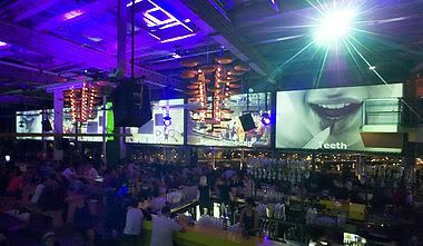

We have a total of 12 screens with Sharp V10 beamers which are wired with BNC cables to a matrix that sends the correct images to the beamer.
Usually a VJ uses only 3 sources and we supply them with a couple of Pioneer DVJ's or they bring their own stuff.
I am looking for a videocard (or 2) that can encode to MPEG2 , control 6 screens independent and preferably has BNC connections.
Here's a pic of 11 (Amsterdam) so that you got an idea of what I'm talking about...

There are no monitors , only Sharp V10 beamers (12 total) and the source is standard 16:9 DVD resolution.
The POP-player (video server) we use sends the images through the Matrix which sends the images to the correct beamer.
