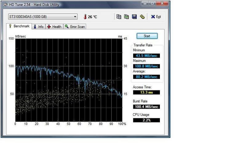

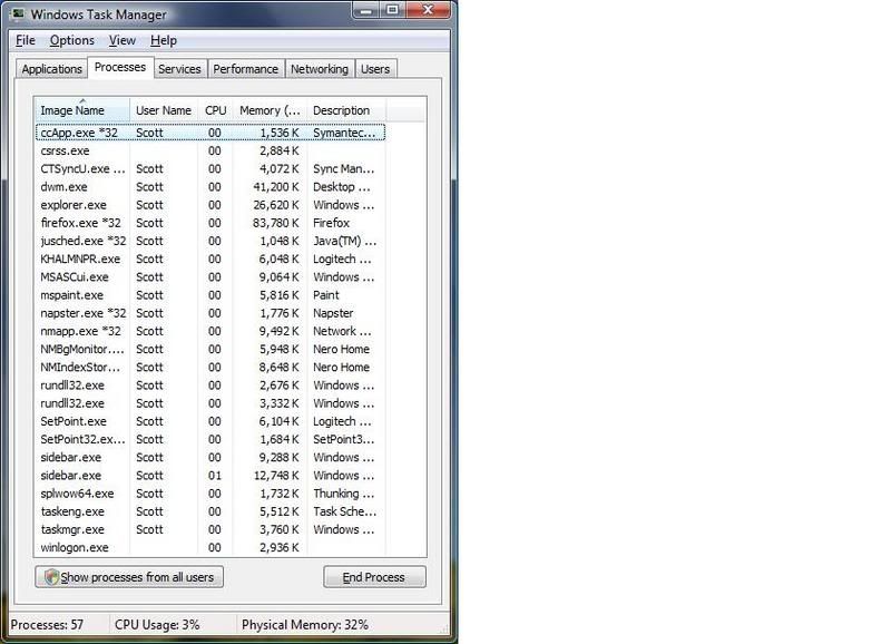

OK - Did a quickie bench using HD Tune. Please note that I did *NOTHING* to prepare for the benchmark. I didn't take anything out of the system tray. I didn't shut down any background programs. I didn't shut off any network connections. No preparation at all. I simply started the comp, checked my eMail and surfed a bit. When the HDD was quiet for a while, I started HD Tune, hit the benchmark button, and went to get something to drink.
I have the normal amount of junk you would expect to see in a HDD as far as programs, music, and whatnot. I think I might have remembered to defrag last week.
System details are posted on the board here - follow the information link. Since it's a measure of the Hard Drive it shouldn't effect the result, but I have the Q66 sitting at an 8 multi over a 400 Mhz baseline FSB (1600Mhz). Ram at DDR2 800 (1:1). North and Southbridge voltages are on AUTO, and the PCI bus is manually set to 100 Mhz. The HDD is plugged into SATA port 0 on a DFI P35 Lanparty Mobo using whatever cable was in the box when I put the comp together. Vista 64, patched to the latest. I have NOT installed any firmware updates, and the HDD is running on the generic windows drivers. HD Tune does NOT run natively on 64 bit Vista, but it does run without making any changes. Meaning I didn't have to specify it to run in compatibility mode.
So, on the negative side: This is a really crap effort, if you can even call it "effort". Because there was no effort, really. On the positive side, its what any schmo can expect to see by mindlessly taking the drive out of the package and plugging it in. Cos that's all I really did. :whistle:
I didn't bother to learn how HD Tune works, but looking at the graph it appears to send larger and larger bites of some info to and from the drive. My little processor monitoring tool didn't budge, and the amount or RAM in use stayed exactly steady at 1.25GB, which is exactly where the system idles all the time.
What was running on my system at the time:
This is the result:
