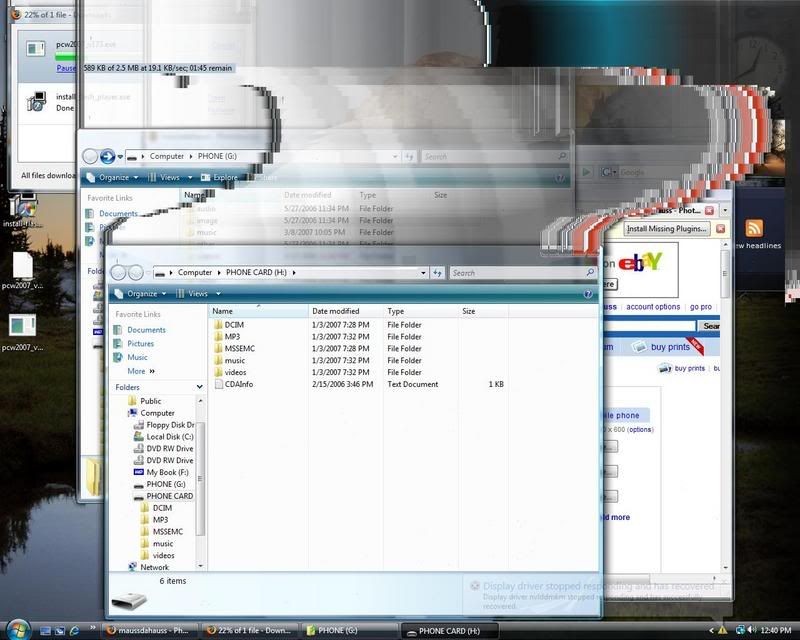

Lastly, even a lot of glyphs and pixels appear on my wallpaper, and they flash on/off, and get worse occasionally, and sometimes go/come back if I interact w/ them such as scroll over them w/ the window, and sometimes they appear over the window. I'll show a pic below:
http://i36.photobucket.com/albums/e24/maussdahauss/retardedcomp.jpg
Those black lines are what I mean by glyphs, and ya, like I said, they tend to dance around a lot.

it's time for RMA. Those lines are usually caused by vram problems.
You might want to run your system with the case off and see if it's cooling problem first.

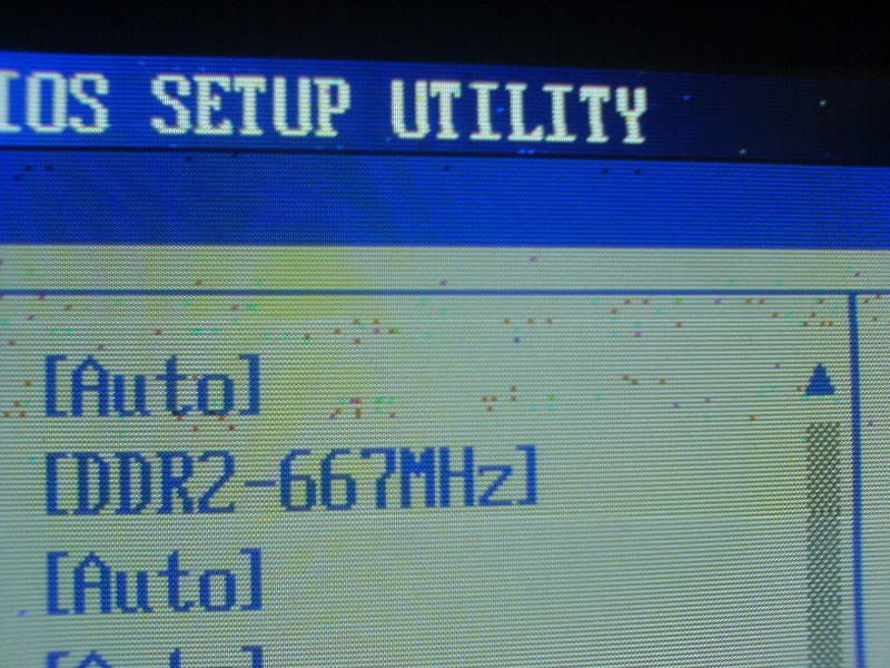

But as for the static problem, I'll include a picture so you can see what I mean:
http://i36.photobucket.com/albums/e24/maussdahauss/DSC00887.jpg
That's from my BIOS menu... as you all prolly can see.. Did you say this would be from my gpu as well?

Try downloading Rivatuner http://downloads.guru3d.com/download.php?det=163 and underclock your card. If it works then you know the card is toast.

If by downclocking the GPU and the vRAM to either reference speeds or lower the artifacting disappears, then you know it's RMA/replacement time. Reference speeds are 450mhz for the GPU and 660mhz for the vRAM.

If you are still getting artifacts at 450/660 or lower, then I reckon your card has bought the farm. Please accept my condolences on your loss. :(

That's bad. Judging from your system it looks like it's the card having the problem itself. Get it replaced.
