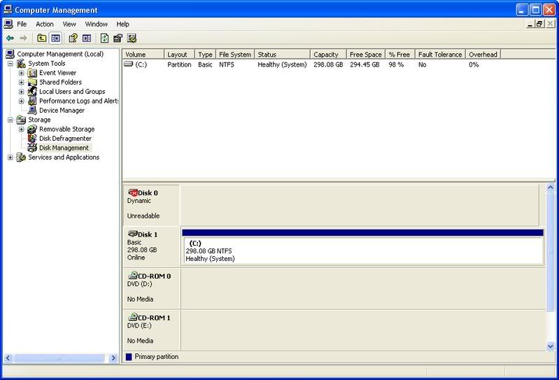

Added 2nd hdd, cant access it???
So yesterday I did an upgrade to my existing computer, basically all new parts. In my previous rig I had a 36gb raptor as my boot drive and a 250gb hdd to store music and stuff. I decided that it would be better to buy a new hdd to use as my boot drive since the raptor was so small, and just add the 250gb that had all my files on it.
I initially connected only the new hdd that I just bought and installed windows XP on it. Once windows had been installed I added the 2nd hdd, so that I can access all the files I have saved on it. My problem is that I can't do anything with the 250gb hdd. It shows up in the device manager and it shows up under disk management in the computer management window. It just doesnt show up in the "my computer" window. When I go to disk management it shows up as disk0 with a big red X on it, says dynamic, and unreadable. If I right click on it my only options are properties, convert to basic, and help. Convert to basic says it will erase all information on the disk.
I tried all that I can think of but can't seem to figure out how to access this drive. BTW, both drives are sata and I am using XP.
Thanks

  3. Go to your disk management and make sure that you are assigning a drive letter to the 2nd hard drive. Because it was actively your C: drive before and now it can't be C:\ drive. So give it a letter like N: or something then you should be fine.
  4. I wish I could give it a letter, I just don't see an option anywhere to assign it one. I have been to the disk management and it seems that there are no options to assign it a letter, other drives let me but not this hdd. Previously it wasn't c:, the 36gb raptor was the C: drive, the 250gb was something like R:.
  5. because it is set as dynamic.. you cannot untie it to the OS it has been created with. get you raptor back, and try to transform it as a normal drive, with partition.
    Or, instal your new hdd, wipe it of all the data on and make sure it is not dynamic. Transfer all your stuff on the new drive, and install XP on the old one

    To make sure that you don't recreate a dynamic drive, you have to click, in the device manager, in the square where it list the drive name, not the rectangle where it shows partition when you initialize a drive, IIRC. But when you start a new drive, and it ask you to create a dynamic drive, always cancel the operation, and make sur you create real partition.

  16. so i got my old rig running and when I go to check the 250gb, it does the same thing as when I put it into the new system. Its unreadable, and I can't do anything to make it work.
    There goes over 100gb of music, and all sorts of other stuff, like pics, movies and such. :(

  18. i don't know if It just went dynamic or if it was always dynamic. I think I figured out a way. While searching for data recovery software I came across a program called easeus data recovery wizard. This let me copy the data on that drive to a different drive. While I was looking through some of the folders I did find a restore point file and some other files that I never placed there. I don't know if that might have had anything to do with it but It did seem strange.

  22. in my case the drive was never a boot drive, it was turned into a dynamic disk for storage only once it was added to a raid 0 array only after the raid 0 array was running as normal with all drivers installed. Upon adding the drive was completely fresh and formatted following it being added as a storage drive . The only way it could be accessed upon being added to the raid 0 array was to add it via nv raid manager utility and I only had choice of adding it as a dynamic storage device. I did not know the hassle of this only learnt this upon disassembling the raid 0 array and freshly formatting both drives upon installing a dual boot OS to one of the drives alone, the second is a storage drive in use now and upon adding the 3 drive with my data on to sata port 3 I see it in device manager but am not able to see it in my computer or access it
    I have downloaed the trail software mentioned above it shows all the files on the drive but I must pay if I want to recover them to storage drive 2 before it is formated which after it would show up in my computer.
    I am seeking free data recovery software that allows one to recover files but I think there is nothing without paying..
  23. Here is the solution that worked for me without having to buy or find software it is built into XP Pro
    Check Disk Management, right click My Computer on your desktop then down to Manage. It's in the Storage section. Should be able to see if it gives you an option to Import the drives\partitions. right click on disk mgmt in the left hand window pane and use the import function, worked like a charm and thanks to "themortman" over at amdmb.com
