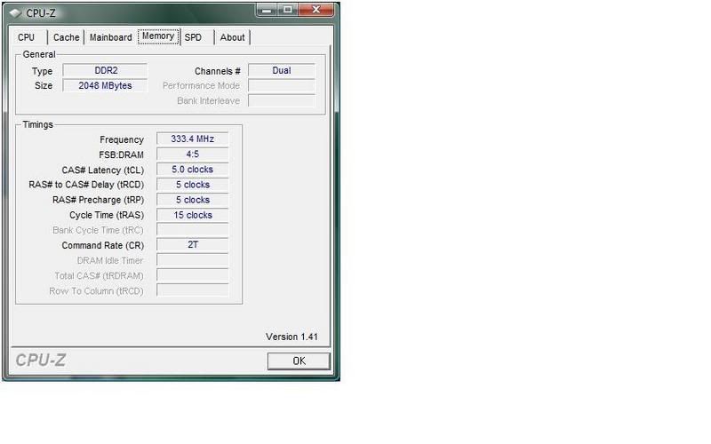

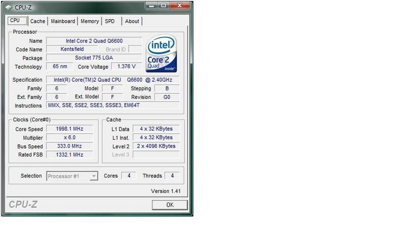

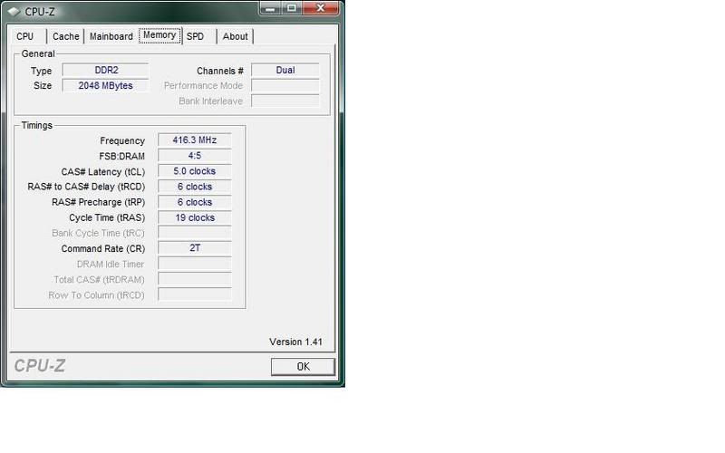

September 22, 2007 12:18:53 PM
Zorg - Heh - I took a sec to run the little windows experience app... It *PASSES* :love:
When I changed the multiplier, I got that red flashing warning that power wasn't optimized (may or may not be a big deal), so I reset it back to Auto. I didn't change anything else. I do see in the EZ Tune app that dropped the voltage to the memory from 2.2 to 1.8. - (CPU is unchanged at 266/1.3/9x, Memory shows 665 @ 1.85V)
Here's your screenies:
September 22, 2007 12:25:07 PM

It ran Prime 95 for about 30 seconds, and then locked up... :cry:  I have CoreTemp keeping a log and it says 65 as the highest. Back to 50 degrees on the restart.
Going back to lower the voltages and see. I'll leave the memory timings alone for the time being.
BRB
September 22, 2007 1:28:40 PM
What test are you running? Run the first one in the list first. Also maybe you should loosen up the tRAS to 18 set in the SPD.
a b V Motherboard
September 22, 2007 1:41:00 PM
I ran the first test...
I restarted, clicked off the Auto Voltage, dropped the CPU to 1.295, FSB is still +0.1, Left the memory voltage at +4 - which put the RAM back up to 2.2. Posted and started Vista just fine. Current temps are all hovering from 43 to 46 deg C.
Firing up the stress test. Perhaps setting the system back to auto-volt, which dropped the memory from 2.2 to 1.8 was a few 10ths too far...
The dinosaur is running just in case..
BRB
a b V Motherboard
September 22, 2007 1:46:59 PM
(posting from the dinosaur)
Test is running successfully so far - Temps have stabilized from 67 to 69 degrees C
September 22, 2007 1:51:27 PM
The SPD says 1.8 at 400x4 but maybe, I still have mine set at 2.2v. Also you should loosen up the tRAS to 18, and set the FSB to auto. I don't need any additional Voltage on that so you shouldn't either.
a b V Motherboard
September 22, 2007 1:58:24 PM
(again from the Ancient One...)
Been running the stress test uninterrupted: Still reponsive to commands... Temps still from 67 to 69 C. Going to stop the test, and dial down the FSB and Memory voltage a bit, to see.
BRB
a b V Motherboard
September 22, 2007 1:59:49 PM
Wow - Dropped 10 deg C the very instant I stopped the test.
a b V Motherboard
September 22, 2007 2:05:40 PM
Strange - It wouldn't let me reset Memory voltage....
FSB on Auto, CPU set at 1.2875. Posts and boots to Windows
