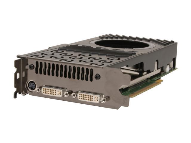

I'm building a work/gaming station and with one 30" monitor and to side 21" monitors. I want to use a 8800 Ultra for the 30", but I dont' know what to do for the side monitors. Should I get two 8600 GTS's to run them or would it be better (one less card and heatsink to deal with) to go with a 8800 GTS 640 MB? Would there be any issues with running two separate monitors on each side of the 30" monitor with one card? Is there a better configuration? The side monitors will have 3D app's running on them at times.

The problem is that I'd like to use a 30" monitor with a res of 2560x1600 and all the ones I know about require both DVI outputs from the video card.
The 21" monitors would be at res's of 1200x1600, but then I would rotate them (NEC makes them). I would prefer to run those monitors off of one card. There will be some 3D action on them but nothing too intense, however I'm worried that there would be problems b/c they would be separated by the middle 30" monitor. When its being used as a work station, one program, Revit will sometimes span accross all three monitors, but I wouldn't have a 3D view that would span across all the monitors. I would have separate views on each.

| ArynBergman wrote : The problem is that I'd like to use a 30" monitor with a res of 2560x1600 and all the ones I know about require both DVI outputs from the video card. |
I believe 30" monitor with a res of 2560X1600 requires only ONE "DUAL-LINK DVI connector", DUAL-LINK DVI connector is a single connector
See more here: http://www.datapro.net/techinfo/dvi_info.html
Most 8800GTS\GTX\Ultra have TWO "DUAL-LINK DVI connector",
I would sugget to get two 8800GTXs, you can even connect four 30" LCD@2560X1600 with two cards.
You can also SLI two cards when play game on 30" monitor.

Cool, thanks, I didn't realize that the Dual DVI is was one connection.
I'm gonna go with the 2 gtx's and if for some reason I need the extra horsepower, I'll add a gts for the 3rd monitor.
