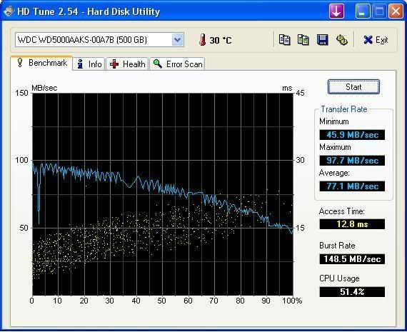

Hey Guys,
Ive seen alot of posts about people thinking about making a new system with RAID-0 but are unsure of the advantages/disadvantages. After my latest build (pieced together from some other parts as well as new ones bought) i did a small bit of testing of a single drive vs a RAID-0 with 2 of the same drives. If there is any other suggested benchmarks that you would like me to run ill give them a go, as i have another 500gb AAKS drive i can install for testing, i have only used HD-tune.
System:
P180
e7200 (OCed to 3.04ghz, i will be pushing this further soon)
Arctic Freezer 7 Pro
Asus P5KR mobo
2x WD 500gb AAKS
Asus 7900GT
First i used the single 500gb drive to install WinXP with only drivers installed (partition was full size of drive)

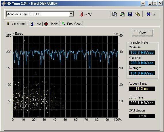

Second, i setup the RAID-0 in the configuration manager (Ctrl+H on boot) took about 2 seconds to do. I then installed Server2008 Standard (sorry for OS change but this is the OS that i will be using with this machine). Again partition was full size of array (~930gb)
As you can see there is quite a performance increase in Transfer rate (close to x2 the performance), access times stay the same (to be expected) burst rate about the same (also to be expected)... What i was a little perplexed with was the CPU usage, although this is more than likely just an anommoly, and i would expect the CPU usage to be lower than the RAID-0 array test. I didnt notice this until after i installed the RAID-0 drive otherwise i would have ran the test again.
EDIT: Just realised i didnt put in some disadvantages of RAID-0, The main disadvantage is that if one disk fails in the array you will loose all data on the whole array. RAID-0 is sometimes refered to the non-RAID, RAID of the bunch (or similar). This is because RAID stands for Redundant Array of Independant Disks, as RAID-0 isnt redundant its kind of a non-event. The other problem that some may encounter is more to do with creating an array with an onboard controller, this is because if the motherboard fails, or you simply wish to move the array to another machine it more than likely wont work. This is because there is no standard for the array information to be stored within the controller. This enables manufacturers so "make" there own system of information store, which other controllers wont recognise. So to transplant an array you will generally need exactly the same or similar chip/manufacturer card for the array to function once moved.

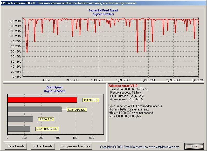

Just a quick bit of extra info for you, I also have a file server running RAID-5 on an Adaptec 3805 controller with 8 WD 500gb AAKS drives attached (3.18TB total) I ran a couple of tests on it as well, i was a little dissapointed with the Transfer rate, however, it is to be noted that the transfer rate doesnt drop over the sustained testing of the entire 3.18Tb volume which is more impressive. I also noticed that HD-Tune didnt seem to want to use the whole array for testing (2199Gb displayed) so i used HD-Tach to confirm results (which reported correct size), this must be some issue with HD-Tune and GPT disks. HD-Tach reported a slightly higher average transfer rate (~20mb/s).
The RAID-0 seems to not only boot into Server2008 very quick, but it also seems snapper in and around the OS itself. Might be interesting to test some games on loading times and possibly FPS figures as well, although im unsure how they will run on Server2008. So all in all im happy with the increase, considering the extra drive was only $95AU to purchase.

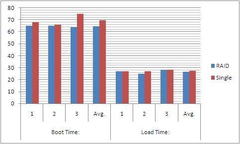

Hey Guys,
Just an update for some of you, I have installed WinXP Pro and SP3 on a single 500gb AAKS drive and the same on RAID-0 array.
First graph shows boot times for Windows off both setups, all times are in seconds
I dont understand why its slower with the RAID, the only thing i can think of is that i have done something different between the 2 builds.

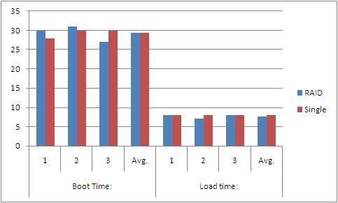

2nd Graph shows boot time and load times for Crysis. This is v1.2 of crysis, and the loaded game was exactly the same (as soon as i got to shore at the start of the game i saved it)
We see here that the RAID-0 array seems quicker although only by a few seconds in each case.

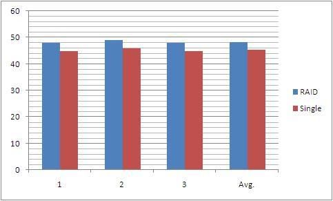

3rd graph shows boot time and load times for C&C3. This is version 1.09 and the loaded game was an 8 player skirmish game with 7 brutal teams in.
We see here very little difference if at all. Averages are pretty much the same.

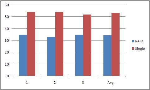

4th graph shows the results of copying a 2gb file from the root drive to the same location (effectively creating a duplicate file in the root directory) this should test copy speeds within windows.
We see here that times are significantly less on the RAID-0 disk, showing that RAID-0 helps with raw file transfers.
All up im pretty pleased with the RAID-0 performance (although OS load times were poor, could be from less than identical configuration on each disk). My main use for this machine will be DHCP, DNS and VMware machines, from these tests i should see better performance in my implementation. Although i dont think id recommend it for gaming as the results wouldnt really warrant the extra $$$ required. Hope this answered a few of your questions earlier, and if theres anything else let me know i should be fairly quick with results this time round.

The real "value" of the AID0 array is in file read/writes. Your final avg graph shows the array with a time of ~34(?)seconds vs ~52seconds for the single drive. (an 18 Second difference.) If you move files around, AID0 is worth it. If you are building a gaming rig, worry about it after you have a nice 22" LCD and a CPU/GPU combo good enough to run it.

Raid-0 shines with sequential processing. OS boot will load lots of small files, so seeking(arm positioning) comes into play. With a file split onto two drives, the positioning has to be done to both drives which adds to the time, and makes the faster data transfer not as important. I think you did the test correctly.
Could you repeat the file transfer test with the source file on one drive, and the destination file on the other drive? I'm betting that arrangement will be much faster than the raid-0 option.
