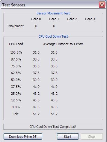

http://www.taservices.co.uk/hardware/prime95.jpg
Difficult to get Prime95 but eventually I found it, temps maxed out at around 65 degrees using the Real Temp Beta but Idle temps are about 45. Be interested to know your opinions. Are my sensors getting stuck?
Reply to banger
They're not getting stuck at these temps, it looks like you'll need to be running cooler to see where they stick. So your temps probably aren't being reported abnormally high, you are idling fairly warm. Most sensors get stuck when >62C distance to Tjuntion max (throttling temp); you only reached 51.7. The good news is that your sensors are moving at about the same rate as each other and it is not uncommon for the sensors in 45nm C2Ds to deviate alot from each other as the chip cools.

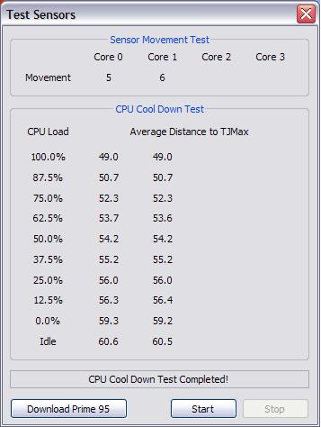

http://www.taservices.co.uk/hardware/arctic7.jpg
Just for balance I fitted my Arctic Cooler Freezer 7 Pro today and above is the sensor test. Temperatures are down 15 degrees with idle about 35-40 degrees and full load a max of 50 degrees. I'm pleased with the cooler. Comments?
Reply to banger
- 0 +
Also what really impressed me was IntelBurnTest at a max of 58 degrees compared to 80 with stock cooler. :)
