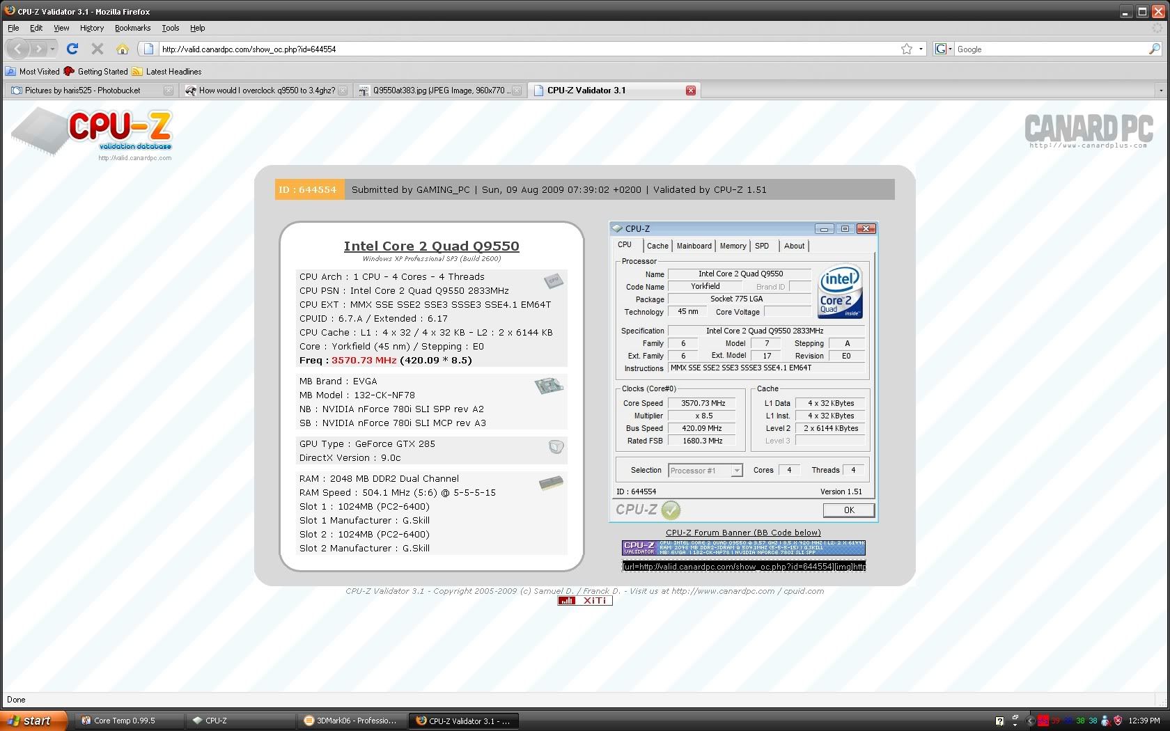

Hi, i have the same cpu as you. Below is my validation, it might make it easier for you to OC, my MB is evga 780i
http://i283.photobucket.com/albums/kk309/haris525/untitled33.jpg
volts
cpu @ 3570 mhz : 1.200v in bios
mem @ 1010 mhz : 2.1v in bios with 5-5-5-15 timings
FSB @ 1.4v in bios
Nb @ 1.50v in bios
make sure you select the unlink option for ram in the bios
if you want more help lemme know i will send you all the voltages/speeds i am using.
that's everything i changed and it worked
http://valid.canardpc.com/cache/banner/644554.png
Message edited by freezed1 on 08-09-2009 at 07:47:08 AM

i have the same cpu and i have overclocked up to 4.00 Ghz with the stock intel cooler!!!
http://img56.imageshack.us/img56/3554/personalrecordbroken400.png
