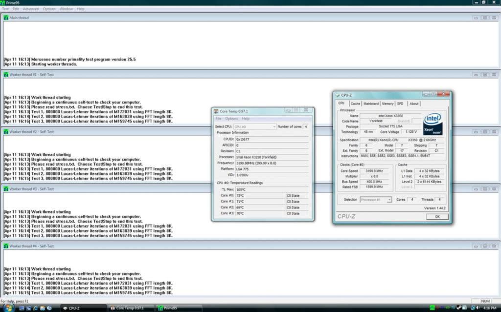

On to the OC! For the first test, I just went to 3.2. FSB to 400(x8). Vcore at 1.2 in BIOS, 1.136 under Prime load. I left NB voltage to auto for the moment. Cores are between 65 and 72c during Prime 95 Small FFT. CoreTemp reports that in Vista finally, but I hope it's wrong.
As you can see, the cores are already pretty toasty. I think I have a little more room to play due to the higher Tjunction Max, but it just makes me nervous :(  I hope I have been bitten by the faulty sensor bug :p  I may download RealTemp and compare, Comp says it is the one to trust now.

Update: Can't get 3.6 to load Windows with as much as 1.4 vcore in BIOS.... Sticking with 3.4, which seems stable at 1.3125 in BIOS.
8:24PM - CoreTemp shows a +10c difference to Real Temp. There is no way Core Temp is correct, because as of right now, it's showing cores over 85c. Surely, that would at least throttle the CPU, if not shutdown. I know the shutoff Tcase temp on the 6750 was 72c. I don't know what it is for the Penryn series.
Real Temp seems to be very accurate. Idle temps in the 40s seems possible with a quad at 3.4. Core Temp shows idles in high 50s, can't be true.
