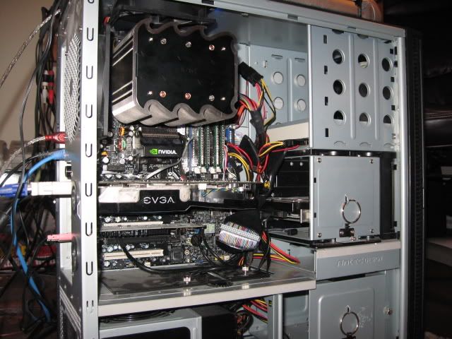

Also i mentioned earlier that i'd post a pic of the inside of the case.
http://i13.photobucket.com/albums/a280/Werak/April2008219.jpg
As you can see i got a nice ratsnest of cords there i'm gonna try clean up.  There's a fan in the front of the case which is the intake, it's pretty much blocked by the mess of cords, and the Hardrive is nestled in there too.  I could try and move the Hardrive down to the very bottom bay on the edge of the screen there. (provided the cords will reach)
The bottom disk drive is a dud which i haven't removed yet.  I'm thinking i'll remove that and put the working on a section down.  Leaving room for a fan to be "rigged" above it to intake are.  ATM i think i lack intake of cool, sort of, air.
Any thoughts or suggestion are greatly appreciated.  I want to get this all planned out...like i thought i did orginally, before i start :)
