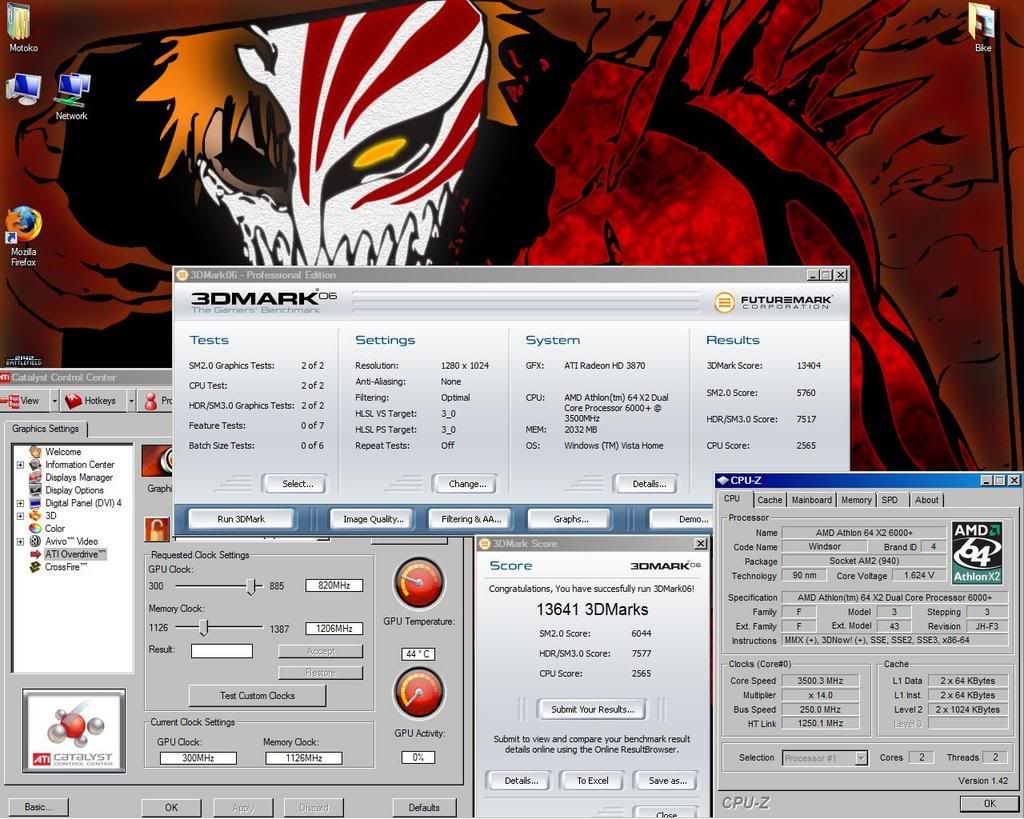

You shouldn't need to lower your HT down that much my old 6000+ ran at 3.5Ghz fine with HT of 1250 on an old MSI K9A Plat. Your voltage is very low compared to what i had to get mine to stay stable @ 3.5Ghz.
I only had to bump up NB 0.2 volts for that stable HT. CPU was another thing, check out the voltage on my old screenie. It took a lot of ine tuning to get it 24/7 stable withouts temps going through the roof i.e over 55 C
You shouldn't really need to raise your RAM timings, but you might aswell till you've reached 3.5Ghz stable.

Wow closed_deal...thats nice! You ran that stable without ever going over 55 celsius? What kind of CPU cooler where you running?

A TRUE with AS5 with 77CFM fan mounted horizontally in an Antec 900.

a vcore of 1.624? That is pretty darn high. I upped my set up to 1.536volts and im getting 63C\57C load. Dfi's meter shows 58C. The Orthos' CPU test fails but the stressCPU has been running for 20minutes.
