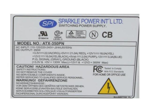

I just got my 3870 in today and it actually works with my 350w psu. Even though its a low wattage it actually supplies the required amps. I haven't tried overclocking it yet, but I thought I'd post incase some people were wondering what kind of PSU they really need to run one of these. I haven't had enough time with it to really burn it in but I tried CoD4,HL: Lost Coast, and the Lost PLanet dx10 demo and it ran well.
I have:
Athlon X2 4400 (very slightly overclocked to run the ram at 400mhz, no voltage increase)
2 500gb hdd's one from seagate the other from samsung
1 dvd burner
1 sapphire 3870
Biostar TF7025-M2 motherboard
Here's a link to the PSU
http://www.newegg.com/Product/Prod [...] 6817103012

Wow u are running a 3870 on a 12v rail. Not dual, one! And you only have like 12 amps. Worst then my Dell 305watt psu.
Reply to aznstriker92
:??: It looks to me like the sparkle 350w in question has a maximum of 25A available on two 12V rails.
That's pretty respectable for a 350w PSU...

Well considering that PSU(the on you linked to) can channel 300 watts into its 12 volt rails, i do not think it is being overloaded(hell if those specs are accurate, its more power then my system uses with its 8800GTX)....Recheck the PSU, if it is in fact the dual rail model(there was an older single rail 18 amp one for the record i DO have both. not that i ever loaded then over 200 watts).
http://images10.newegg.com/NeweggImage/productimage/17-103-012-03.jpg
Either way the 3XXX cards are quite a bit more power friendly then the 2XXX series.
really? maybe I read the specs wrong....
25 amps on the 12+ rails...it's not bad. 3870 doesn't require much power, so you're not really pushing anything.
