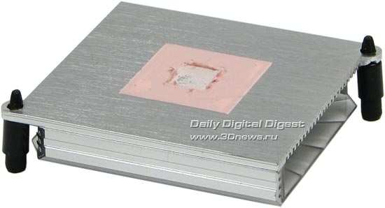

Did you put new heatsink compound on fan and clean old away before remounting?
this is bad and needs to be cleaned:

You need to clean and reapply thermal compound every time you remove your heatsink.
That pink crap in the picture is almost impossible to remove w/o putting scratches in the metal. It's almost like rubber or glue. :p  (I had an old ECS chipset HS with that on the bottom and was scraping it off one day.)
