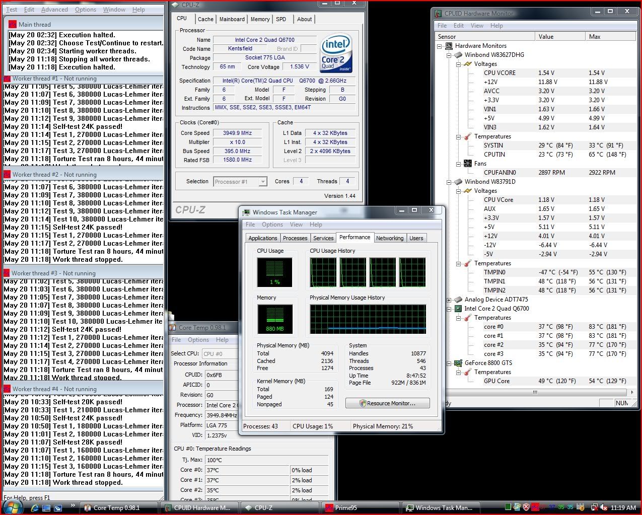

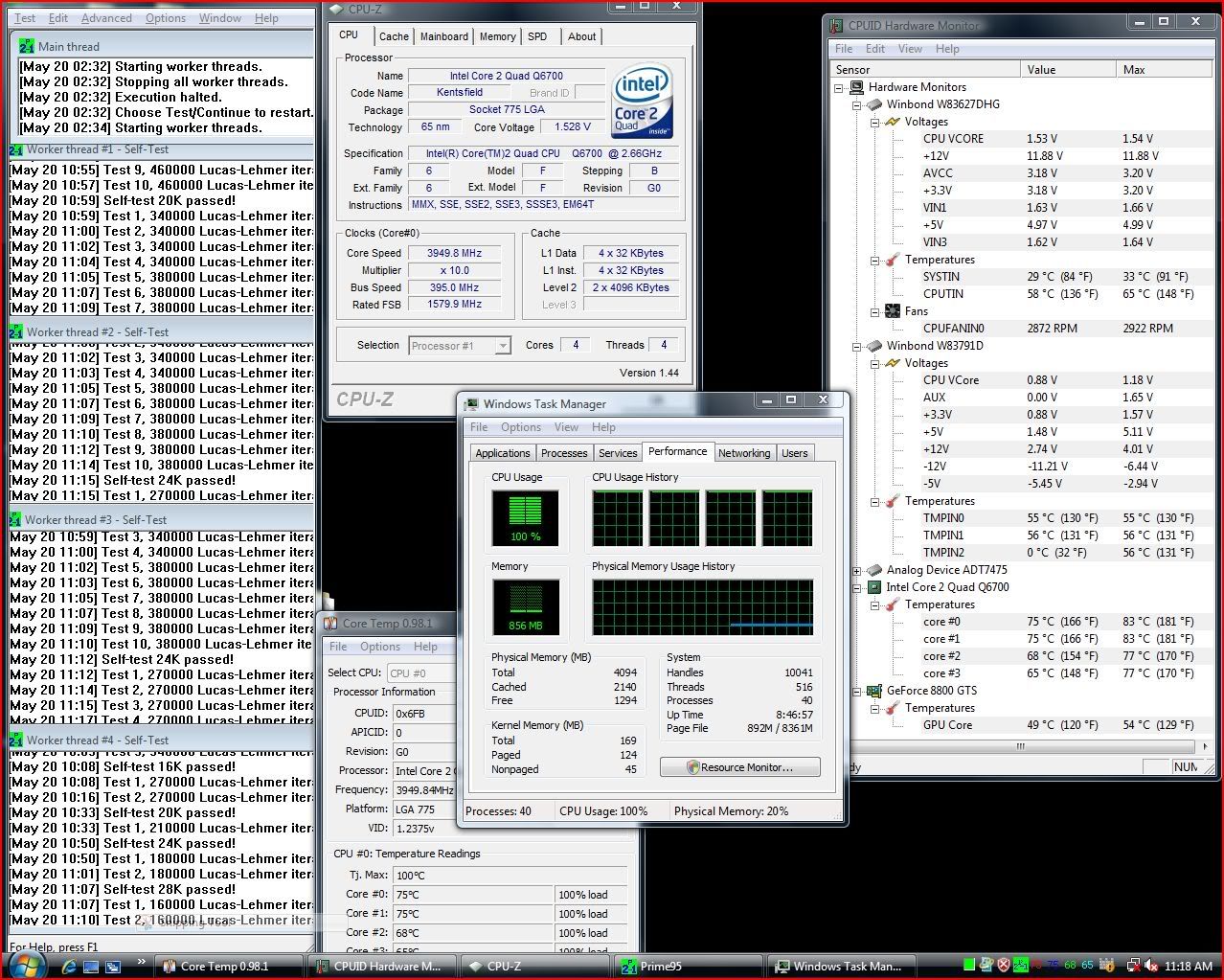

Once again I was board and just playing around to see what you can get with these things and not over volt by to much. Unfortunately I did have to go over the 1.5 volt spec limit, but I had to at least get a somewhat decent speed from it, right?
Prime 8 hour+ Loaded:
Prime 8 hours done and idle:

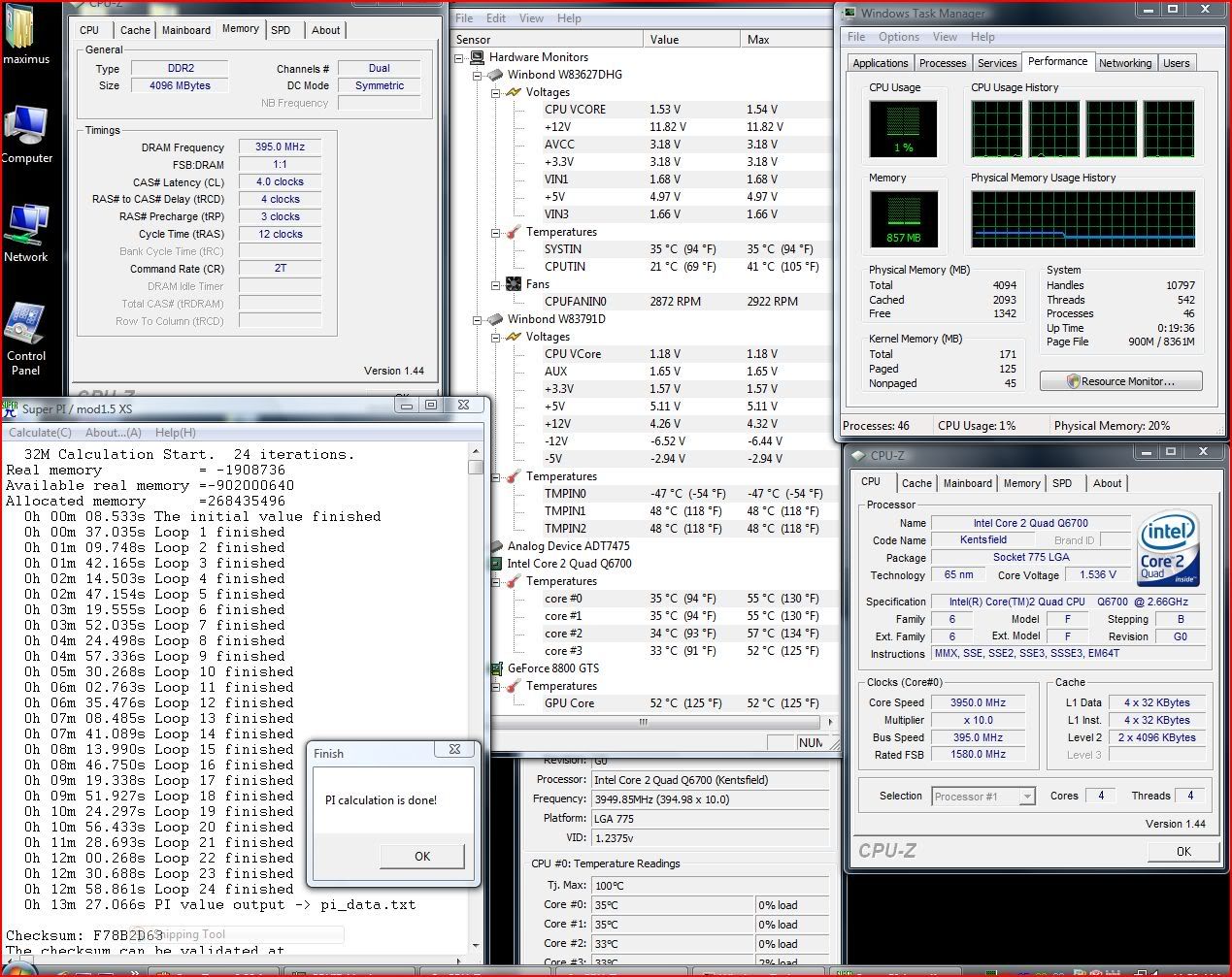

Super Pi complete 32 mill:
Idling Super Pi afterwards:

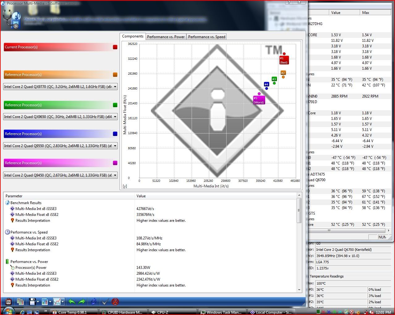

Saundra Multi Media:

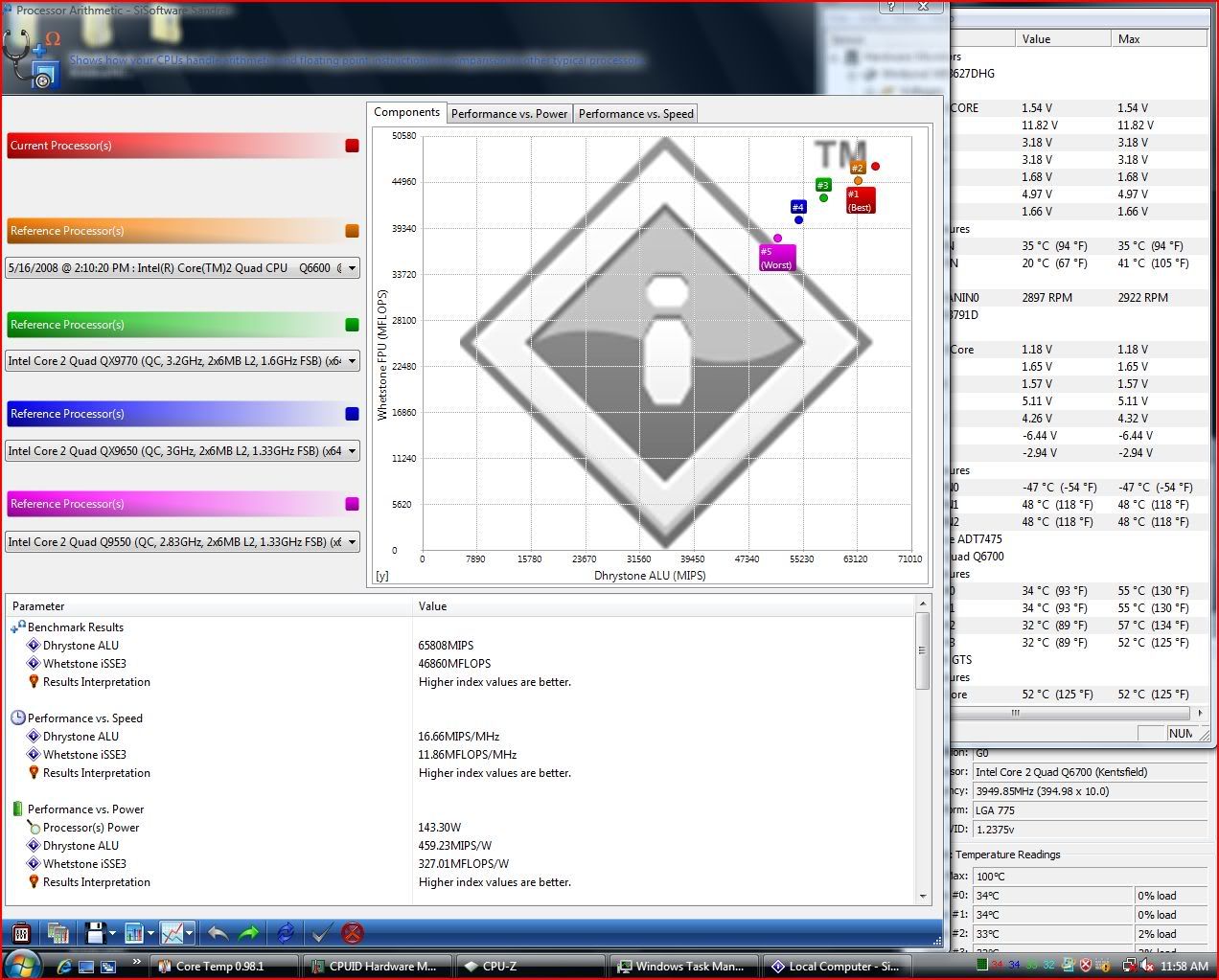

Saundra Processor Arithmetic. (I placed it up against my 3.8 OC of a q6600 that took 1st place.)

Hehe, she wasn't even close to doing that! And yeah, its hot. But what did you expect? Thats a hefty Over Clock for a q6x00 series! After all, it was just over volted a small amount outside of the specs!
Swapped Saundra P.A. tests, because the highest ranking chip it tests against is the new tech at 3.2 Ghz. Placed it up against my 3.8 q6600 that whooped the a$$ of that 3.2 Ghz new tech chip.
Of course, they are un over clocked. :)
