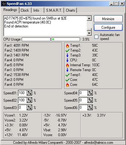

Hey akhilles, thanks for the help. I had run memtest previously because I thought it was memory as well but it went on for 3+ passes and no errors. I ran speedfan and the picture below shows what it reads. I have no clue as to what fan is what when displayed on this. Funny thing is that the computer runs fine on its side. I had removed the side panel and then replaced it to test to see if it was heating up. the computer runs fine with the side panel and when it is on its side. If you can help me with speedfan i would appreciate it.

Ok, ASUS mobo comes with a cd. Find it & install ASUS PROBE. Compare their readouts against Speedfan's. You'll find what they are. In Speedfan, click configure, under Temp tab, highlight a temp name, hit F2, rename it to match ASUS PROBE's.
Not all the temps are relevant. You should be looking at cpu temp. For details, go to:
http://www.tomshardware.com/forum/ [...] ture-guide
What's your case? Is there a drive space between hard drives? They're pretty hot. I'm guessing it's Temp1-3. My old Maxtor is 37C right now.

hey akhilles thanks for the response. I had asus probe installed and ran it and i figured out which is which. The CPU is at 58-60 degrees but I think that might be a bit buggy. I remember when I first installed this board, the cpu temps were around 30-45 degrees. Then one day my bro was using the computer and somehow a hex binary or something got corrupted and I had to repair windows 2000 and reinstall the drivers for the motherboard and thats when I started getting weird readings for the CPU. in any case I called AMD and found that even though the temps are reading high, its within the max. temp set for the cpu. The rest of the readings seem to be ok. the case fan, the power and the mobo are all pretty low. I run 2142 and the temp of the CPU doesnt budge at all which makes me think that the CPU reading is off. The computer doesnt hang at all on its side or even while running 2142.
