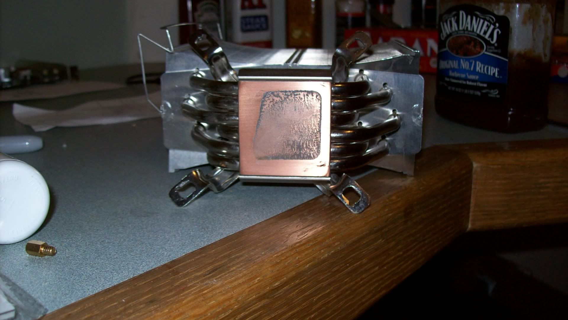

And no, prolly nothing wrong with the board. Maybe the Bios is incorrectly translating the info? Did you calibrate real temp? You can always pull the heat sink off and check to see how well it was mounted. Easiest way is to clean em both off. Apply paste to the CPU, nice thin layer over the whole thing, and then set the cooler on it, give it a little wiggle and mount it as usual, wait 30 seconds and take it off.

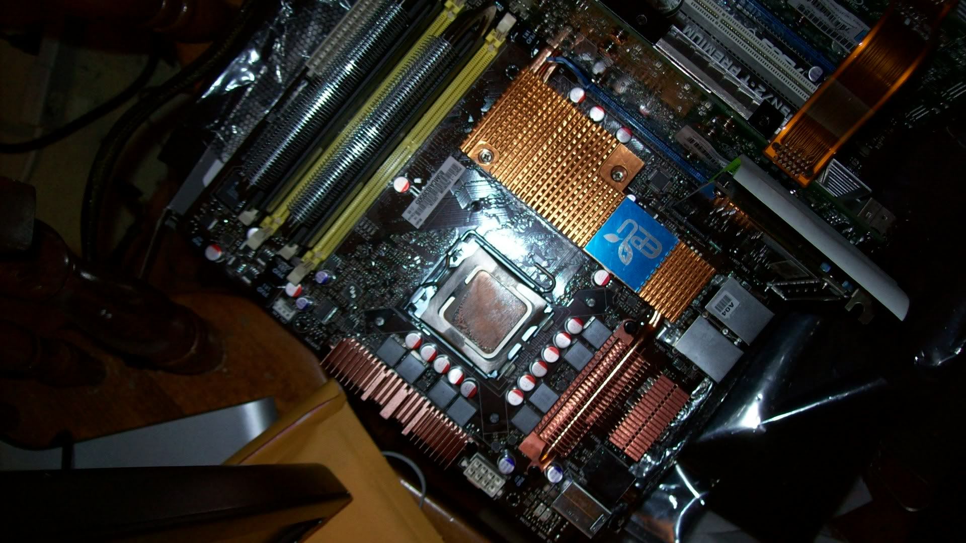

Then all you have to do is look at the heat sink, and you can tell how well its making contact! Maybe you will get a chip like I have! The best q6600 VID 1.2000, and it came where 30% touched the heat sink, because the Integrated Heat Sink on the processor was totally slanted. I had to remove via lapping half the IHS, and now 90% can touch the heat sink, however, I was scared to remove any more, because I have no clue how thick those IHS's are!
Scopith forth!
Hehe, and BTW, that's how easy it is to tell with the paste test. You can see the area very easily that STILL doesnt contact my TRUE.
Nuts, huh?
Damn intel, but at stock, like it was supposed to run, the temps were like under 20c and farther, because of the low VID.
--Lupi
