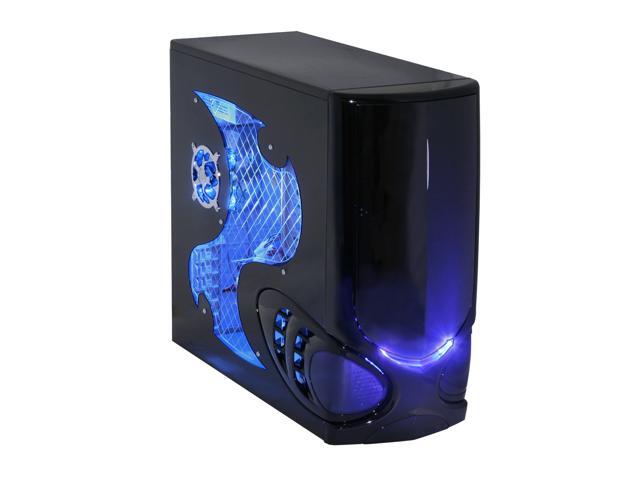

Looking at your PC case, is it this one?
http://c1.neweggimages.com/NeweggImage/productimage/11-156-177-19.jpg
http://c1.neweggimages.com/NeweggImage/productimage/11-156-177-17.jpg
It seems you have a side fan thats only blowing on top of the 9700, and really is not helping in air flow. Kinda wonder if the Zalman fan is actually going to having problems. And what I mean by that is if it is being slowed down from the pressure the side fan is putting on it. I think the design of that case was to help air get pushed in for a stock HSF that blows on the MB, not inline with the exhaust fan that it does have on the rear.
Also, not sure if you have a front intake fan installed, since the pic shows none installed, and that HD cage doesn't help.
I'd recommend shutting the side fan off, adding a front intake fan (and if you can, remove the HD cage and get a HD bracket for the 5'25 slot), and also getting a slot fan to help reduce the heat loop your having with the 8800 GT. Something like this should be good:

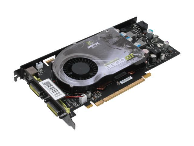

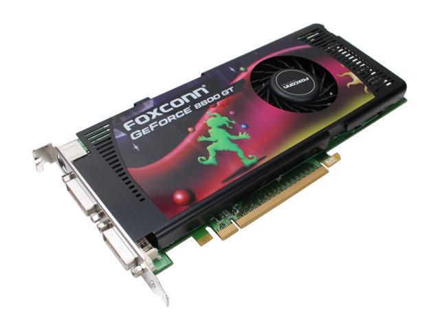

Since all 8800 GT cards have different style of stock HSF, it's also important how the slot fan sits between the video card and the slot fan. That should also be taken into consideration. Examples are:
http://c1.neweggimages.com/NeweggImage/productimage/14-150-272-02.jpg
and
http://c1.neweggimages.com/NeweggImage/productimage/14-186-031-03.jpg
So just mess around with the fans to see if you can improve the airflow. Never know what you can come up with to help cool the system.

@ Grimmy, The case in the picture is my case but the fans are different.. there is about 3 fans in my case and then the CPU cooler (Stock HSF).
I also took the CPU cooler off the E6600 to see if the thermal grease was alright and noticed.. there is a few spots were the thermal grease has worn away (Not the best words to describe it) but it looks like there is hardly any grease left on the chip/HS. but dont matter tomorrow my new CPU cooler is coming.
