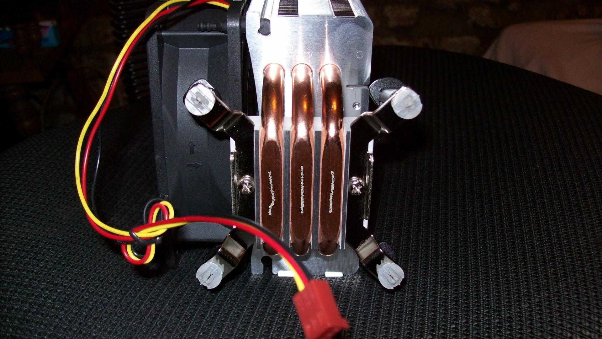

But have you already tried to re align your cooler? You have to make sure the middle heat pipe is running down the cores, and you have to apply paste to just the heat pipes themselves. Three small thin lines down each heat pipe where it contacts the top of the processor. Non on the processor.
And if you are half way smart, you can get 4 almost inch long screws and 4 matching small bolsts. Then snip off the push pins, and try and do it yourself. Just poke the screws through the holes and bolt down on other side of mobo. You should get good temps from that xiggy that way! (I hope!)

That's how the paste should go.
http://i225.photobucket.com/albums/dd5/Lupiron/p5n72-t008.jpg
Thats how the middle heat pipe should go. Right along that line.

I think what ill do is check to make sure the xiggy is aligned right later then I will go to Home Depot pick up some bolts and try to make me a homemade retention bracket. :D
Reply to Shawnhath
Thats what I did!
They have two small sizes that should work great, sold in packs of 6. 6 screws and 6 matching small little bolts!
No "bracket" needed. Your mobo has safe spots for bolts to be on the bottom through each screw hole. I did use washers myself, but they are not needed either!
