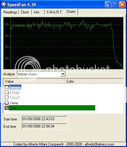

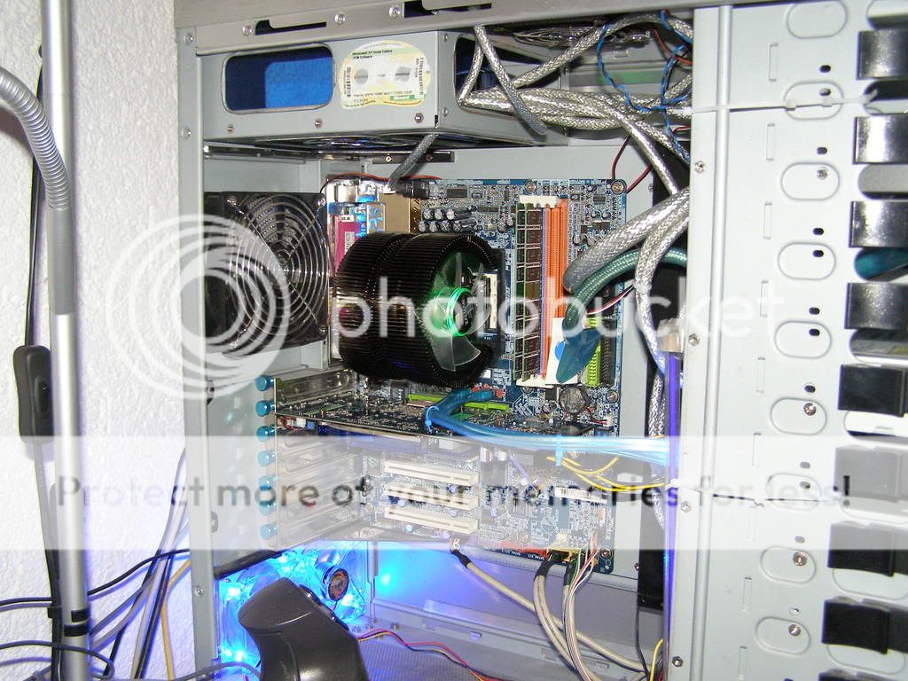

seems better than before but still too warm for comfort. Anyone got any good websites for thermal paste application as I feel this may be where I am going wrong, especially considering the fact that its dual core, if that indeed changes anything? As you can see have a new heat sink properly orientated and tidied up my cabling. Seems to cool down a lot quicker than before after use but must admit am still concerned about hitting the 60 under load.
Thanks for all your help so far by the way. Any further suggestions greatly appreciated.
tim
