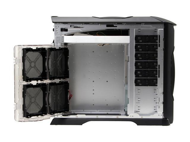

With regards to the airflow, I have:
Front: 2x 120mm Intake
Side: 3x 120mm, 1x 140mm Intake (CM Stacker Fan Rack)
Top: 1x 120mm Exhaust
Rear: 1x 120mm Exhaust
(Sorry, misquoted the fan details in the original post.)
Cable management w/ zip ties, and tucked away what I could, wish I'd gone with a modular PSU.
I'm wondering if I should reverse the 140mm? Right now it intakes onto the Zalman, while the Zalman is blowing into the rear fan. Maybe that's screwing up the exhaust process? Not worried about overpressure, as the case has so much ventilation it's practically a sieve.

Heh.. that's allot of fans to figure out. Thing is, the Zalman 9700 was designed more from a case with a front to back type of airflow. Having 3 fans on the side of the case, blowing down on the 9700 doesn't exactly help the airflow.
I'd try to run it without the side fans first, then go from there. Perhaps adding one on the bottom bracket to help the gpu out a lil, but having all 3 there (guessing the 4th won't fit with the 9700 in there :lol:), you prolly should have went with a cooler that was designed to blow down on the MB to help cool other components.
Just my 2 cents.

Yeah, the fourth fan bracket slot (that faces the Zalman) wouldn't fit a 120 x 25mm fan because it just barely touched the Zalman when the rack was closed, which seemed bad. So, I removed the bracket and placed a 140 x 20mm fan in there instead. Thanks for the tip on the flow, I'll try removing some of those side fans and see what happens!

So, I reversed the flow of the two rearward side fans, so that they now exhaust. (Saw this recommendation on another forum.) This helped my temps slightly.
I then set the core voltage to 1.25. These are the total results:
Idle temps dropped 2-3 degrees, to ~ 35 C.
Gaming temps also dropped 4-5 degrees, to ~ 49 C.
Everest stress test dropped 7-8 degrees, to ~ 65 C.
So, this has helped! :) Although, I'm not sure if these temps are where they should be? Should I try 1.21 core voltage?

For the case always have airflow going from the front to the back. Any on the top will pull air up and side will pull air in. PSU should also pull air up and out the back(if dual fan on bottom and back) if dual fan one inf front and back PSU should pull from front to the back. I have a 120mm fan on the side blowing nice cold air on my GPU and my Zalman 9700 and if I open the case and put my hand inside it feels nice.
