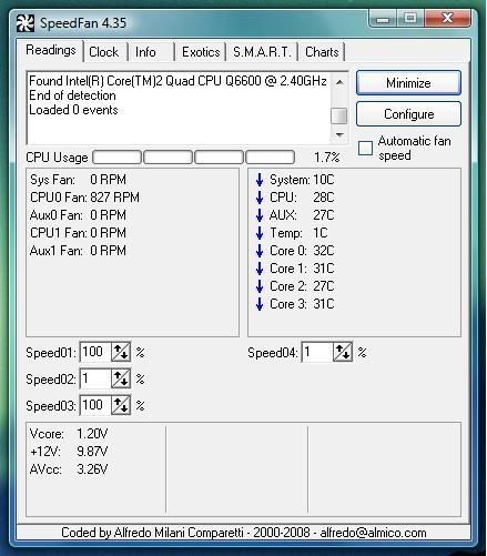

I am wanting to overclock my Q6600 my stocks temps are as below.
with these temps I would like to try and get at least a minimum of 3.2 if anyone can help me that would be amazing as i don't really know much about OC'ing.

ok so i changed myt fsb to 340 and at this moment my idle temps are
this is with all my voltages at auto still will run p95 for a couple hours and will screen shot and post those temps
