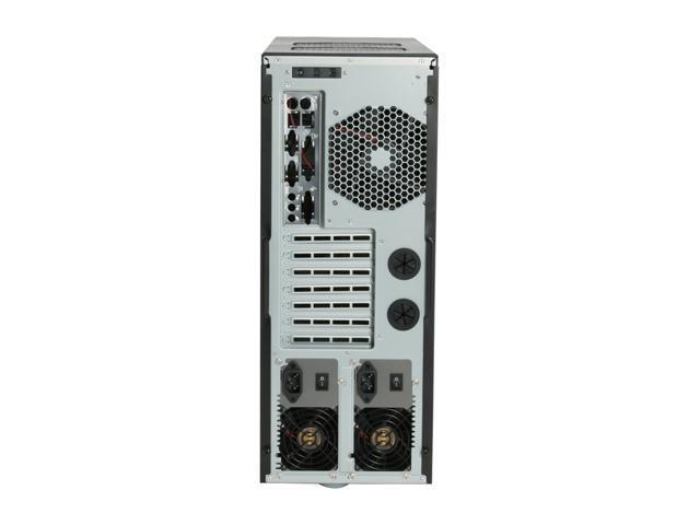

If he does run into watt/amp probs which i doubt he will he could always throw 2x1500w in this case. http://www.newegg.com/Product/Prod [...] 6811129028
http://c1.neweggimages.com/NeweggImage/productimage/11-129-028-08.jpg
EDIT: I just realized that 4GPUS wouldn't fit in this case sorry for the inconvenience
