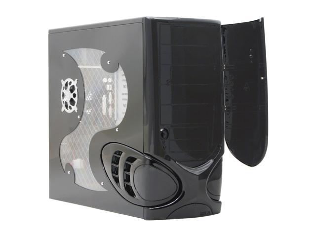

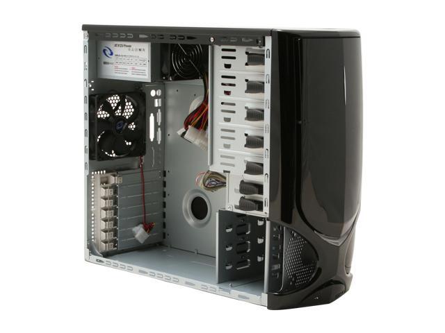

This is your case?
http://c1.neweggimages.com/NeweggImage/productimage/11-156-177-23.jpg
http://c1.neweggimages.com/NeweggImage/productimage/11-156-177-17.jpg
Never did like those HD holders like that in the front intake.

Insufficient airflow on those - very similar to the V1000 and onwards Thermaltake's (Zaser Etc).
I machined the back grills right out (I have the smaller fans ulike this one with the single 120) to inprove the ariflow and did the same at the front at the bottom.
You need air to travel over the HDD's and (mixed with the cool air coming in from the side) and out the rear of the case.
It's actually a pretty poor design fault of the entire series.
Designed by a bling arketing person and not an engineer.
Neon lights draw moths ... I removed mine ... gave them away to some other retard.
Because the rail kit for the HDD's also insulate them from the rails you get no additional heatsink value from the case for the drives and they heat up ... end up dying earlier.
Plus the doors on most of the Thermaltakes are a poor fit and the hinge design causes an annoying vibration.
The PSU is good quality and their fans are also robust.
The case looks good but beneath the bling value (like most) is a case not designed for gaming.
