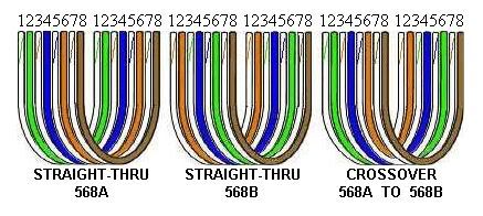

Know your cables! This card does not perform Auto-Configure, only Auto-Negotiate.
You may have a bad cable, or an incorrect cable, or a cable that has wires flipped internally the wrong way.
The same thing happens when I plug the cable from the modem (that normally goes into the router) directly into the D-Link port--it still says a cable is unplugged, but the diagnostic tool is still able to test the cable. (However, in this case it says there's an "impedance mismatch" in one of the cable pairs along with the two shorts. Again, I know the cable is functioning - I'm using it to post this message.)
There's that cable issue again.

No, cables are cheap. Buy a new Patch cord and see what happens.
As for the Ethernet port on the motherboard, it does something different. When I plug the cable into it, it takes a long time but eventually says it's successful at acquiring a Network Address. At that point, in Network Connections it says it's connected (at 100mb/s), but I can't get on the internet. Do I have to do something else to make to work? Set up an Internet Connection? Would I need to restart for it to even work? (I didn't)
No restart needed. It's taking a long time to negotiate the cable error. You may be working on cross-talk between wrong wires.
My primary concern it getting the D-Link working, but if I can get the mobo one working at least I might be able to use the internet on the new HDD and not have to switch back and forth (I'm afraid of damaging the IDE cable). I just hope there wasn't a more serious reason why they added a new Ethernet card.
They added the new card to give you gigabit speed if you connect to another giga-speed device.
Please let me know if there's any other information I need to post. I may be able to take screen shots as well.
All patch cords are not made the same. They should all work the same, but sometimes a system is picky... here I show the differences in cables and that they should work the same, but sometimes won't.
