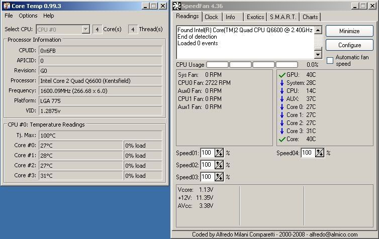

First here are my temps at stock idle. Ram is set to stock 1066 for a 1:2 ratio. Looks good so far.

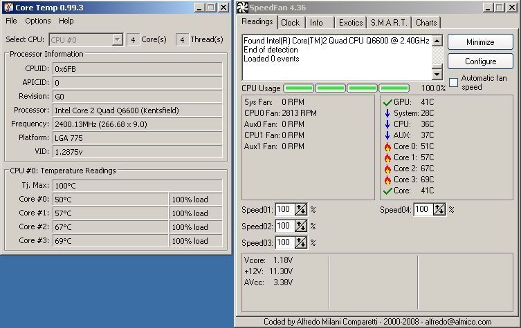

And here are stock temps at full load running Prime95.
A little bit high, but within safe temps from what I've read. The difference in temps between core 0 & 1, and core 2 & 3 is kinda odd to me.

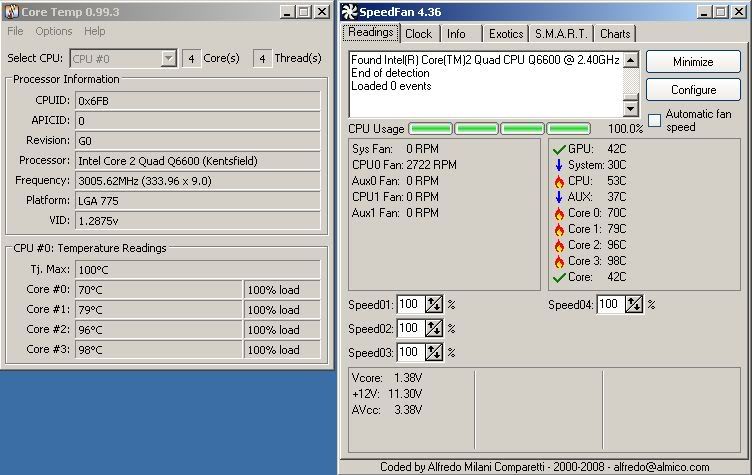

Now here's where it gets fun. Temps at full load running Prime95
As you can see crazy temps on core 2 and 3, and again a huge difference in temps between the first two and second two cores. I didn't let this go on long, but I was curious to see if the PC would shut off so I let it run for about a minute. It didn't shut down or report errors.

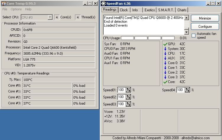

Ok Vcore is way too high on auto. Next attempt I changed Vcore to 1.2875.
Temps on idle.

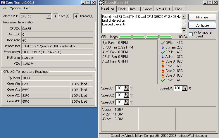

Ok, time to lower the Vcore even more. Down to 1.25.
Temps at idle.
Temps still way too high.

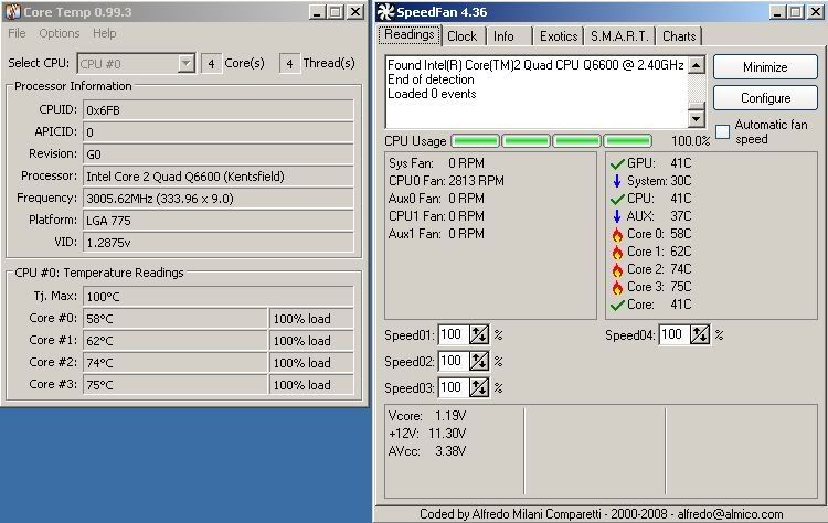

Lower the Vcore even more. This time to 1.2.
Temps at idle.
Still kinda high, but not quite as bad. I let Prime95 run for about an hour this time since the Vcore was so low I wanted to see what would happen. No errors.

December 4, 2008 1:49:42 AM
You need to reseat your heatsink. I believe that cooler is the pushpin design which is not what you want. You actually want the retainer bracket type. That way you have really good contact between the heatsink and the processor. Also make sure you follow the arctic silver 5 directions for quadcores on their website. It will explain how to put on thermal paste. Even if you aren't using AS5 I would still follow those directions. If you have everything done correctly then I would remove both of those and get a razor blade and use it to see if if how concave or convex the factory heatsink (grey part of the processor covering the cores) is (do this also for the aftermarket heatsink. There is poor contact. Also you might want to make sure that you didn't apply too much thermal paste as it can actually hinder thermal transfer. Other than that I don't know. 99.9% that it is one of those. Good luck.
December 4, 2008 1:50:46 AM
It looks to me based on 2 cores being way hot that either you have a convex or concave side of the factory heatsink over the cores OR one side of your cooler isn't seated well to the motherboard with the pushpins.
